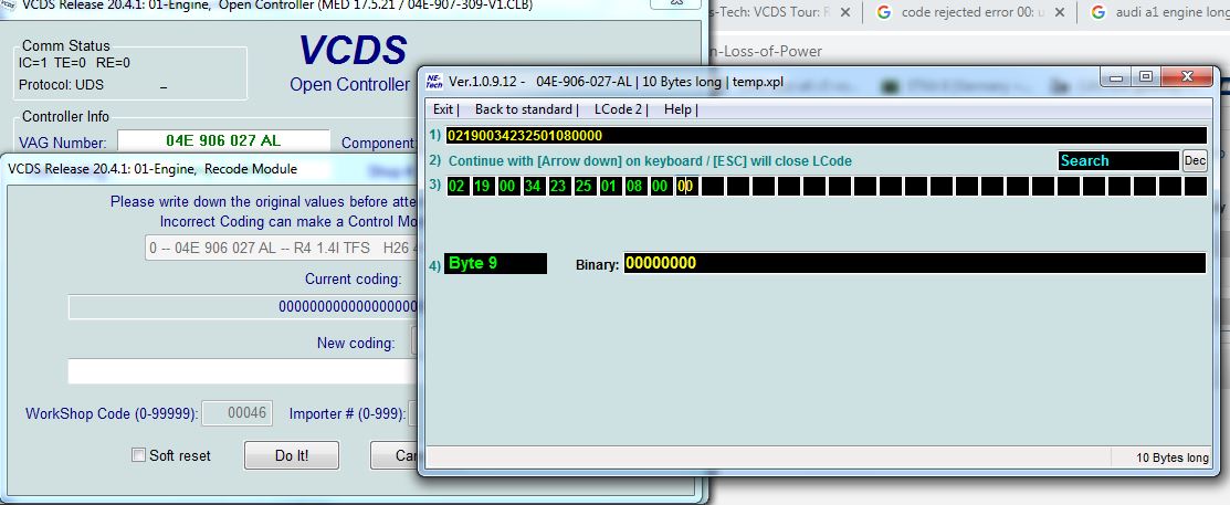

Hi Guys,
Purchased an Audi A1 TFSI from a salvage auction which did not come with keys, front end had been stripped. New key programmed by Audi
Noticed EPC and engine light on. Loss of power when accelerating and engine shakes. Scanned the car using VCDS and noticed a number of errors. Checked all pipe work and fuses, any ideas
Btw - Its a manual transmission

Address 01: Engine (J623-CZCA)       Labels:. 04E-907-309-V1.clb
   Part No SW: 04E 906 027 AL    HW: 04E 907 309 AC
   Component: R4 1.4l TFS   H26 4697
   Revision: R7H26---
   Coding: 00000000000000000000
   Shop #: WSC 00046 412 00000
   ASAM Dataset: EV_ECM14TFS01104E906027AL 001008
   ROD: EV_ECM14TFS01104E906027AL.rod
   VCID: 6ED32A3EB13819F6E0-803A

10529 - Engine Control Module Incorrectly Coded
          P1612 00 [175] - -

ECU coding of all zeros seems incorrect. Coding is documented. Use the Long Coding Helper. :)
Iffykhan
Apr 22, 2017
29
7
C?ID=443464
Hi Uwe,
where can I find the coded document, sorry new to ross tech forum
I've tried the long coding, but it s not saving. Unless I have not select the correct options
Thanks
iichel
Aug 10, 2016
3,768
4,182
Netherlands, eastern part
C?ID=284912
Random scan from the net says something like 00190032242401080000
Go to 01 Engine, Coding, Long code helper and see what info there is.
Iffykhan
Apr 22, 2017
29
7
C?ID=443464
Hi,
Selected each bit option available . Still get code rejected
Can anyone provide the code
Thanks
PetrolDave
Dec 16, 2014
8,052
7,877
Westbury, UK
C?ID=1423
Have you tried the long coding suggested by iichel?
Iffykhan
Apr 22, 2017
29
7
C?ID=443464
my bad.. I was going through the options.. wooohooo all sorted
Thank you iichel
