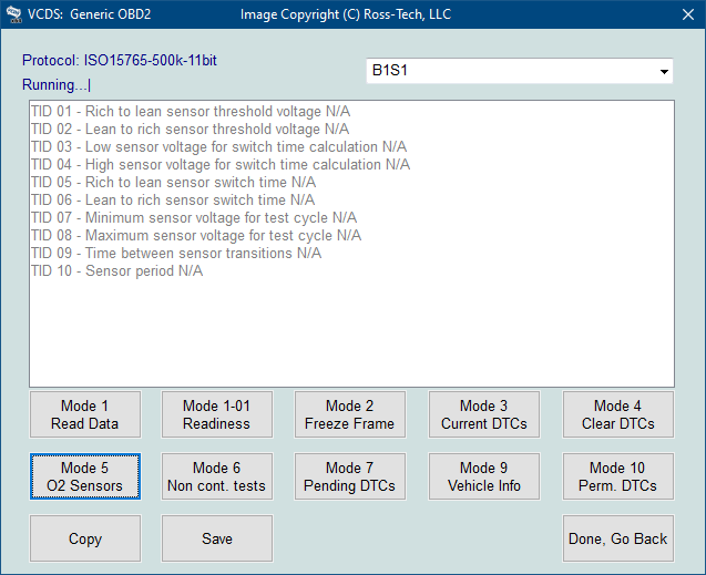

Hi, just a quick question when I try to perform the basic settings for oxygen sensor it just keeps saying test on and keeps running. How long is this test supposed to run because I was holding accellerator and brake for 10-15min and it still did not complete.
Its a 2010 Audi a5 2.0tfsi vcds version 14

Yes Apr flashed, I have no codes and have completed this once before but its just sitting at that screen. Exclude the failed/incomplete for catalytic converters. I am only looking to see how long the test is for on the oxygen sensors. Here's image of readiness.
http://s30.postimg.org/gr3nh0635/20141125_101428_HDR.jpg

If you have a not deleted or altered any of the emissions related equipment, you will most likely need to road test the vehicle for 5 - 10 miles at highway speeds (above 50mph), include a couple key cycles and repeat as needed until Readiness monitors have been set or until fault codes are present.
- If after 2 or 3 drive cycles there are no codes and the Readiness monitors have not set, talk to your tuner.
- You can also post an Auto-Scan, maybe there is an ECM update for your vehicle.
. . . by the way, did you try to use Basic Settings [200]?
- If not, try that and follow the instruction messages, basically you will need to Press [On/Off/Next] to turn on BS and then press/hold the brake pedal and then press/hold down the accelerator pedal, ECM should control engine speed and the value block field will count down as the tests run and complete.
Hope this helps.

Drpeter, I have driven over 200 miles with a few key cycles. I have tried the basics settings but there's no script to follow so I have to go thru each channel manually and it just keeps running "test on"
And test steps still to be performed is 0
49,725
34,021
If, after several days and several hundred miles, you still get this:
.... and no fault codes...
Then you really do need to talk to your tuner. Get them to flash you back to stock, at least for the time being..
- Agreed with Uwe, above, flashing back to stock will tell you a lot.
This is interesting, maybe you should post a before Auto-Scan, so we can have a look at a few things, and then see if anything changes after the flash back to stock, thank you..

Any faults stored? This can prevent readiness tests from starting.

By the way, I noticed in your Auto-Scan, the readiness reads differently than your readiness status on the screen-shot, did anything change (clear codes, try and set readiness)?
In scan = Readiness: 0010 0101
In screen shot = 0010 0001

Thanks for posting the mvb to advanced measuring data information. When I do the log and get a response from Apr I'll post what they come up with.
In the generic obd II there's no pending codes either.
I do have a question regarding that screen though. How come the mode for oxygen sensors is greyed out?
- Perhaps that [Mode 5] is not available for this ECM configuration.
- You are referring to this page, right?
drpeter
correct, that and Mode 6. was just a side question lol.
- Okay, so it does appear that not all OBD-II functions are supported by these controllers. All questions are good, "Judge a man by his questions rather than by his answers".
