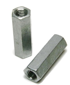

    Now install a nut on the air motor and in the car with actuator air motor unsecured still & install a coupling nut and tighten it, further shorting the distance by 2 MM approximately or until spring pull tension is achieved to seal the WG valve.
    Now tighten the jam nuts against the coupling nut.

    A quick link to what a couplings nut is.....

    You don’t mention what size coupler is needed. May I assume that it is different sizes on different turbos? Any way to find out what size is needed without removing the turbo?
  9. #6
    14,101
    Measure the rod, thread it & install coupler for size threaded. Usually 5 or 6mm but some use American stuff so whatever you want.
