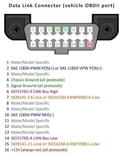

    TIME TO STOP FOD & ISOLATE ABILITY TO COM
    Okay now no one can whine I don't have a WD when I say JPPSG and go find pins and manually connect with ECU.
    Also see this thread & Go play with Don and Dr. Z : https://forums.ross-tech.com/showthr...estbench-setup
    MED 17
    5 : +12V ( term.15 )
    1 : GND ( term. 31 )
    87 : +12V ( term. 30 )
    92 : +12V ( term. 30 )
    68 : CAN High
    67 : CAN Low
    MED 9
    3, 5, 6 : +12V ( term.15 )
    1, 2, 4 : GND ( term. 31 )
    87, 92 : +12V ( term. 30 )
    86 : K Line
    68 : CAN High
    67 : CAN Low
    EDC16
    EDC16U1, EDC16CP34, EDC16U31
    18 : +12V ( term. 30 )
    72 : K Line
    89 : CAN High
    66 : CAN Low
    ME7.1.1 add T81/PIN 62 B+ for Terminal 30 for ME7.5
    3 : +12V ( term.15 )
    2 : GND ( term. 31 )
    21 : +12V ( term. 30 )
    43 : K Line
    60 : CAN High
    58 : CAN Low
    BOSCH EDC15, EDC15V, EDC15xx & P
    2 : +12V ( term.15 )
    5 : GND ( term. 31 )
    16 : K Line
    37 : +12V ( term. 30 )
    82 or 7 : CAN High
    83 or 6 : CAN Low
