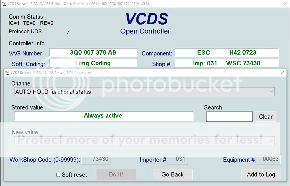

    It would seem that this should be quite simple, there are 2 channels in the ABS module. 1 I can change the other a security code is required. Both are set to not active by default. The first one below is to set when it is on, options are never, always, and basically what ever the switch says (which the Octavia doesn't have) and may not need if it's set to always active like I have done below.
    All I need now is the security code, I have tried all the ones available and most are accepted, unfortunately non of them will allow this change to be made. Help :-(

    What codes have you tried?
    I have tried the following which were all accepted under 03, but without success to change the ‘drivers door status’:
    11966
    15081
    20103
    24435
    25004
    31857
    37202
    40168
    These were all rejected:
    10505
    18573
    28183
    44595
    31347 was also tried but can’t remember if it was accepted or not but was no good for the adaptation I needed.
