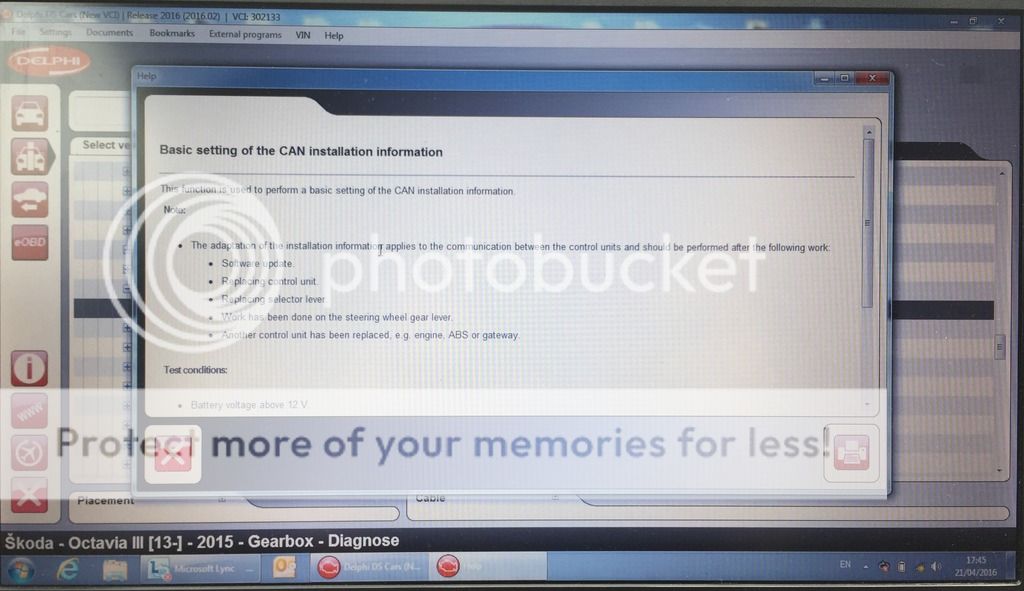

    It turns out that the CAN installation has to be reset in order to cure this issue. I have another diagnostic tool which did this very easily (VCDS may do it but it wasn't obvious)
    Thankfully normal order has been resumed.

    Ps VCDS will do the CAN installation reset but it asked for a 3 digit code to do it (nothing listed in any help box) so I had to use my Delphi tool to reset the CAN again after trying (that didn't require any code).
