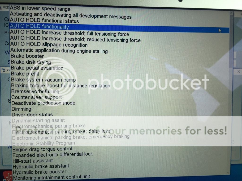

    I'm trying to get Auto Hold enabled (this function causes the brakes to remain 'on' when the vehicle is stopped, so that you do not have to hold the brake pedal at lights, in traffic, etc).
    I know it seems like a silly thing, but drive around every day in NYC and you'll realize how useful it can be. I miss it from my previous car (a Mercedes C class).
    Vehicle is a 2016 A3 (8V) US model.
    This is the modification in question:
    Adaptation of the functional state of the Auto Hold setting - NOT TESTED
    [03] Brakes Electronics -> Adaptation ->
    Select AUTO HOLD function state -> Set value: (Default: last setting)
    Last setting: AUTO HOLD uses the last defined setting which was set over the button
    never active: AUTOHOLD not automatically activated
    always active: AUTO HOLD always enabled
    These are the security codes we know of for this ABS module, and I have tried them all with the following results:
    ABS CODES ATTEMPTED FOR AUTO HOLD ADAPTATION CHANNEL:
    18573   'controller refused the key'
    44595   'controller ref the key'
    28183   'invalid key!'
    11966  engine on - 'sec access req'                    	engine off - 'sec access req'
    15081  engine on - 'sec access req'			engine off - 'sec access req'
    20103  engine on - 'sec access req'			engine off - 'sec access req'
    24435  engine on - 'sec access req'			engine off - 'sec access req'
    25004  engine on - 'sec access req'			engine off - 'sec access req'
    31857  engine on - 'sec access req'			engine off - 'sec access req'
    37202  engine on - 'sec access req'			engine off - 'sec access req'
    40168  engine on - 'sec access req'                     engine off - 'sec access req'

    Ok so credit to DJAlix for finding the ABS security code (24990) for the channel AUTO HOLD Functionality.
    With this code, I was able to change it to "active".
    I expected to find another adaptation channel "AUTO HOLD function state" which can be set to "last setting" "never active" or "always active". Without that setting available, I do not believe auto hold can be turned on short of installing the button.
    Anyone? At least it's progress...
    EDIT: Some more info...
    This is the adaptation map with the "AUTO HOLD functional status" channel that I was expecting:
    ;SW:5Q0-907-379-AC HW:5Q0-907-379-D --- ABS Brakes
    ;Component:ESC H75 0437	Coding:01FA8AA1202312700377060701C32980510448C0608094F3002A0028C1
    ;EV_Brake1UDSContiMK100IPB	8020	EV_Brake1UDSContiMK100IPB_AU37.rod
    ;Saturday	2	August	2014
    ;VCDS Version: Release 12.12.0 Data version: 20130910
    ;VCID: 7DF1154CECFCAFF6FF5-8028
    ;With access code for module controller
    ABS in lower speed range	activated
    Activating and deactivating all development messages	0
    AUTO HOLD functional status	Last setting
    AUTO HOLD functionality	not activated
    AUTO HOLD increase threshold; full tensioning force	10%
    AUTO HOLD increase threshold; reduced tensioning force	0%
    AUTO HOLD slippage recognition	activated
    This is what I am getting on my vehicle:
    ;SW:3Q0-907-379-AA   HW:3Q0-907-379-F ---  ABS Brakes
    ;Component:ESC           H42 0623	 Coding:13FF6A9234210A73017F030681CB29C8562C5080C08194B6024100548208
    ;EV_Brake1UDSContiMK100IPB	34036	EV_Brake1UDSContiMK100IPB_AU37.rod
    ;Wednesday	28	October	2015	15:34:54:59061
    ;VCDS Version: Release 15.7.1 (x64)  Data version: 20150904
    ;VCID: 79D71FE2F83FE7F61A-802C
    Activating and deactivating all development messages	not active
    AUTO HOLD functionality	not activated 	       [OK, this line now says activated, posting an older admap here, but otherwise identical]

    We have been looking into this for a while.
    I have scanned 2 vehicles (mk7 golfs) both with auto hold, neither of them had the "auto hold" adaptation set to active.
    This leads me to believe the function lies in the coding of the module and not the adaptation channels, despite my best efforts I cannot makes many changes to the coding without the error "coding rejected, out of range"
  10. Likes ineedbeer liked this post
  11. #8
    Jun 2014
    56
    I can confirm that this function is not in the adaptations.
    As a test I have set my channels to "active" for AUTO-HOLD and "always" for when to be active as I don't have a switch. This doesn't work.
  12. Likes ineedbeer, jnvwtechacct liked this post
