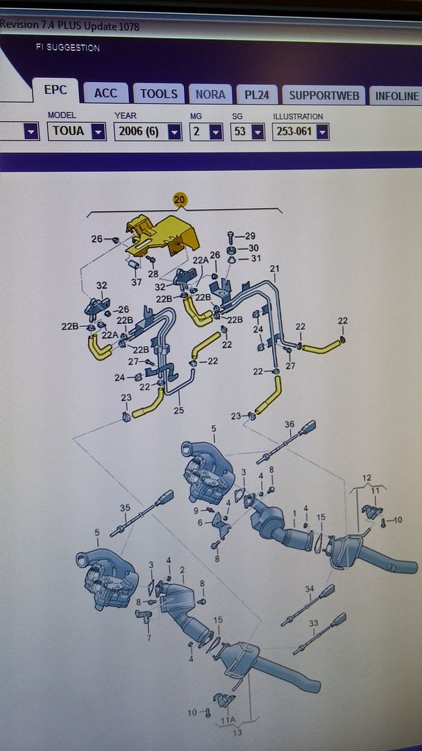

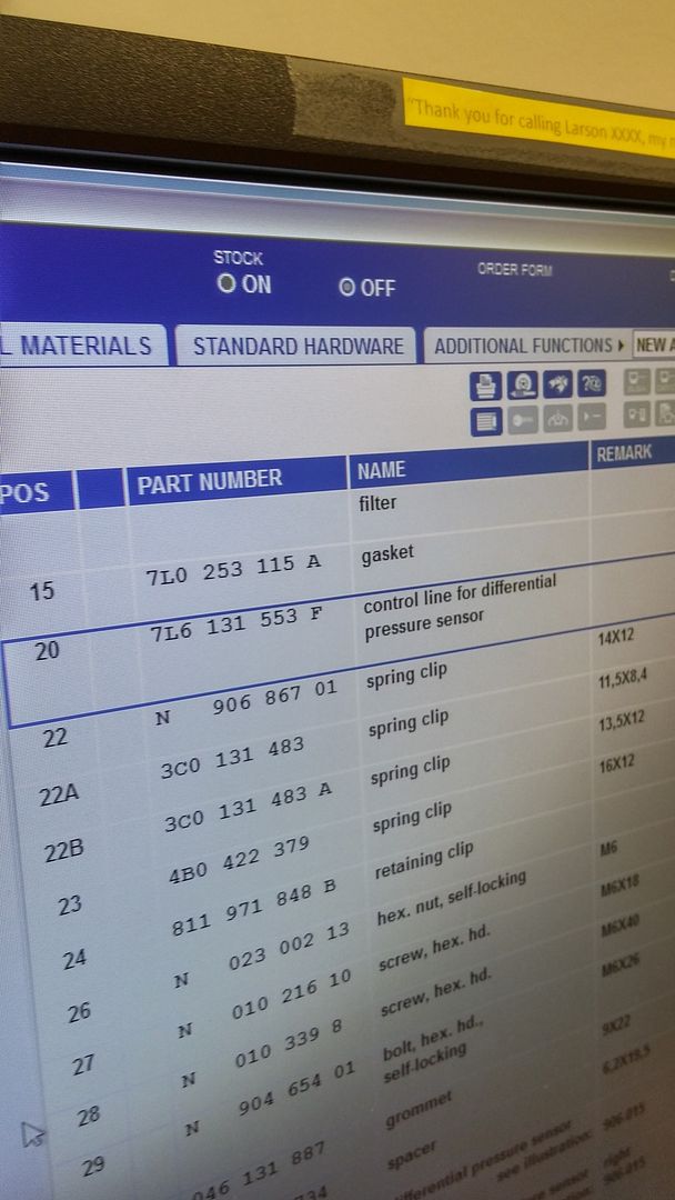

    So about the hose.
    She wasn't kidding. I was off, but it was in the $320something range. The good guy price is $281.
    See, you have to buy the whole set that is highlighted. Those pressure sensors, items 32 in the diagram (not included) are up on top of the transmission. Ain't no way in hell I'm doing those. There must have been something about my facial expression after she said "well you might as well do them all as long as you're in there". B**** I ain't in there, I'm under there with hand tools and a bad attitude. That was when she offered me the good guy discount.
    This stuff don't come from Pelican or Rock Auto.
    I asked her if there was a tech around who could tell me what type of hose I could find. You don't sell someone a seventy five thousand dollar car and then eight years later tell them "we don't carry those parts". I can go to the Porsche dealer, and with an generous supply of personal lubricant, be sure that I can leave with parts for my 16 year old Porsche.

    She came back with a chunk of hose that looks exactly like the stuff I picked up as plan B from the auto parts place. She told me the tech said that the hose in her hand was too large (he was right), but that kind of hose should be okay.
    I'm skeptical as hell.

    Flaps measure the inside and outside of those hoses........ I might have some bulk packs of double braided for the PSI sensors cheap!
    Genuine hose units I bought for other cars I cut to fit that have the bends.
