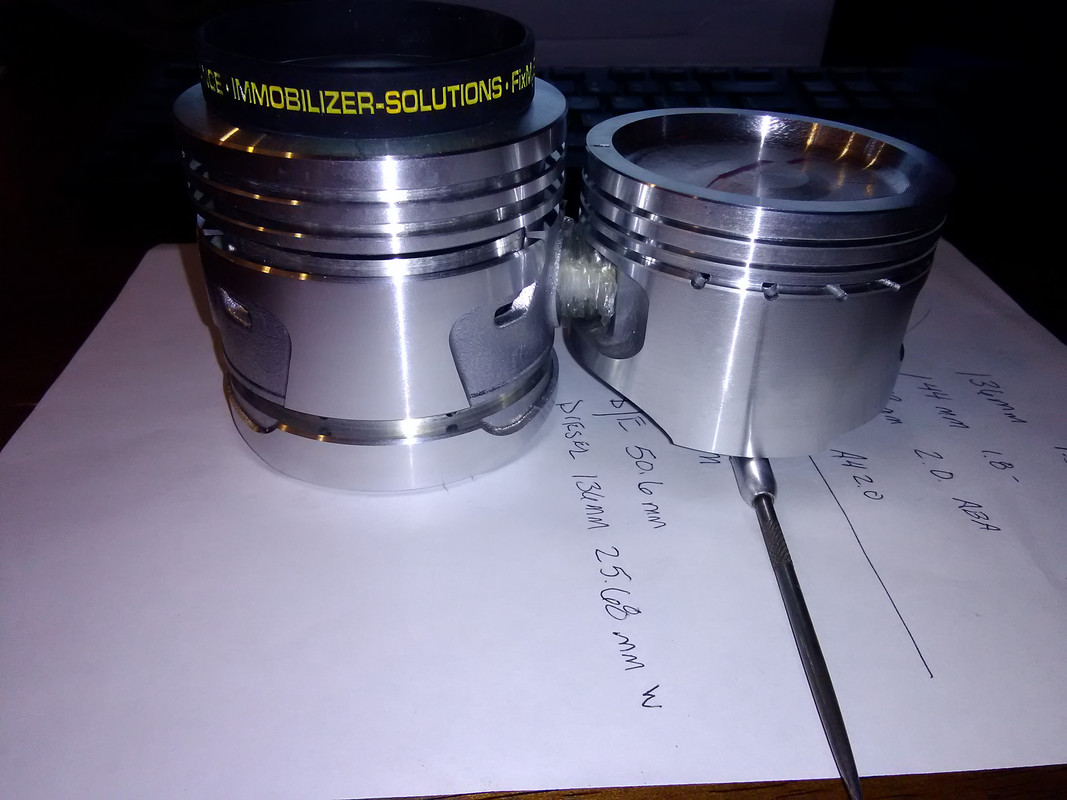

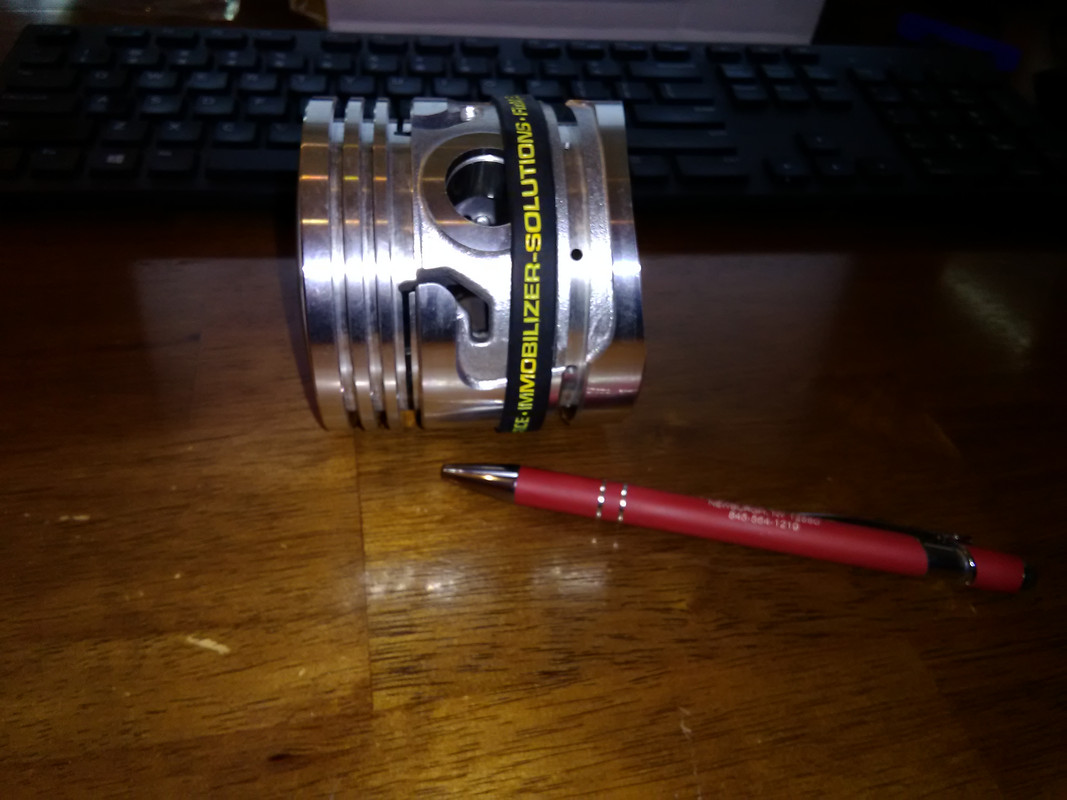

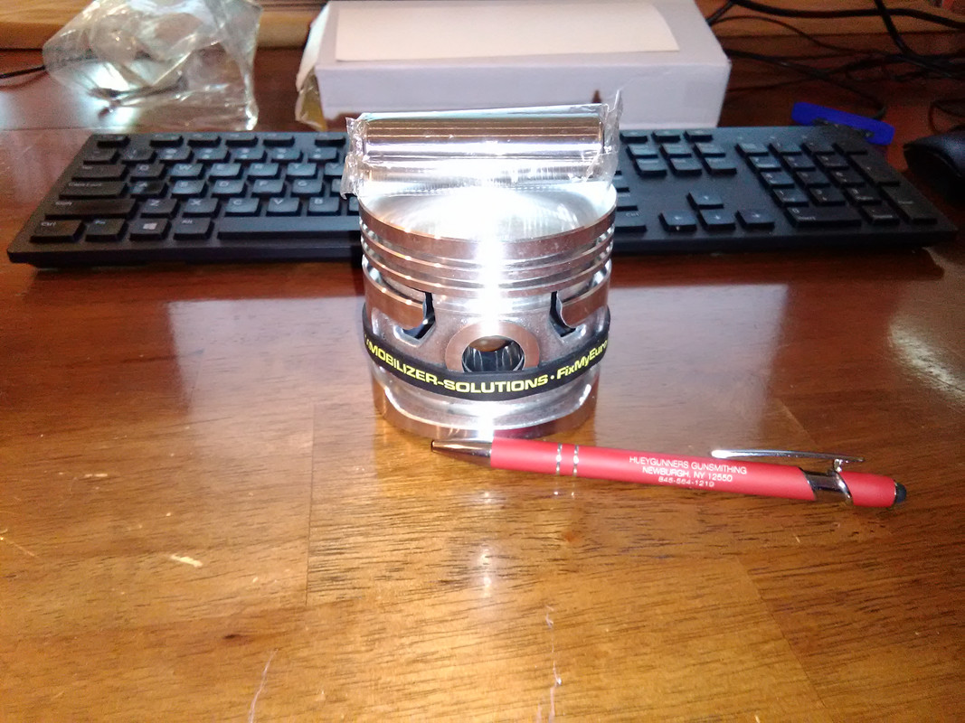

    FOD PROJECT PISTON SLAP + BLOW BY BE GONE + 1 = 4 & THICK RING FUN EXPERIMENT!
    INDUCED FOD PROJECT PISTON SLAP + BLOW BY BE GONE + 1 = 4 & THICK RING FUN EXPERIMENT!
    BACK TO BASICS .......
    FUTURES PAST COMES BACK TO HAUNT THE PROCESS AND WHY OR HOW COULD WE OF LOST OUR WAY!
    OIL & GAS CONTROL OR PISTON RESONANCE FROM SLAP ARE REAL, THEY EFFECT USEFUL LIFE, PERFORMANCE & SMOG!
    2 x THICK 5 MM OIL CONTROL RINGS AND TWO DOUBLE THICKNESS COMPRESSION RINGS 2 x @ 3 MM THICK!
    WILL THE ADDED COMPRESSION, WEIGHT, SEAL, MAINTENANCE OR LINEAR OPERATION ADD HP AND TQ WITH GAINS THAT EXCEED THE DRAG DEFICIT + LOWER SMOG OR WILL IT JUST GRENADE?
    TIME TO PUT IT TOO THE TEST........LET'S FIND OUT!

    I been studying the conditions a long time now and measured the case PSI as Deterioration Factor "DF" sets in.
    By the increased weight shear forces are indeed increased, however, the piston being held center in engine by an additional lower ring and extended length will remove slap and resonance aiding in useful life and overall performance.
    A short light cut piston & with smaller rings, doesn't deal with or do well during normal useful life. Just look at the blow by gasses being generated and widespread issues with PCV or rear seals
    So many service histories in TSI , with low end failing and not like the 1.8T did & since no HPP or as many chain's.
    Look at all TSI chain or adjuster failure is clear it is widespread isn't it?
    I think this initial contamination of gasses and fuel is what ends up taking out the sump, block & an HPP too. It exacerbates the issue, since it's in a last spot lubrication point when this component itself starts a dump of fuel to sump.
    Now the injectors too are an issue, it is clear to me & at especially very high RPM ranges. The injectors can't withstand useful life for proper operation, however, maybe if not under such stress and were used in a lower RPM range, the heat and resonance might increase life?
    It's my believe the oil contamination is what damages the parts far more exceeding the risks to curtail these aforementioned observations.
    To be clear this experiment is to increase useful life stock not an effort to get HP on a dyno in an unusable RPM range.
    Now it is my belief that if max TQ can be moved in a slower RPM range of combustion process. A much smaller turbo can be used & with correct gearing, a car would be much more feasible to drive and fun.
    Almost any racer do two things I see.
    They lighten it all up and they steepen the final drive to get the TQ back. They do this to move faster at a higher RPM, however, engine's do not last and are torn down frequently as result.
    I think it's time for a new approach from what history taught us a long time ago, with NOS and water injection in aviation.
    Also the VAG blocks seem to hold up very well in my experience for bore wear and reliable from 70 's up however, it has always been an issue for rings fatigued or head issue's and caused by fueling.
    Amazing how old gas and diesel engines with many miles, the cross hatches from the last hone were still evident when observation of bore was done and how nice the cam lobes with solid lifters were....fond memories!
