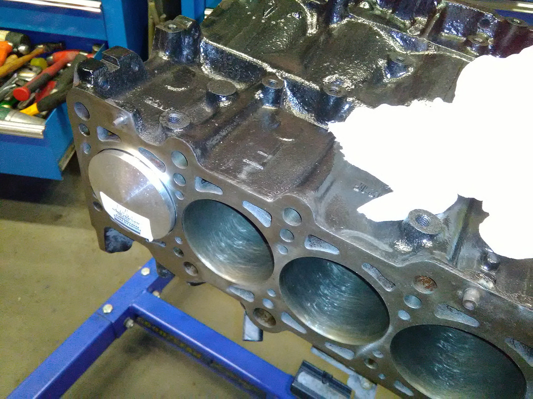

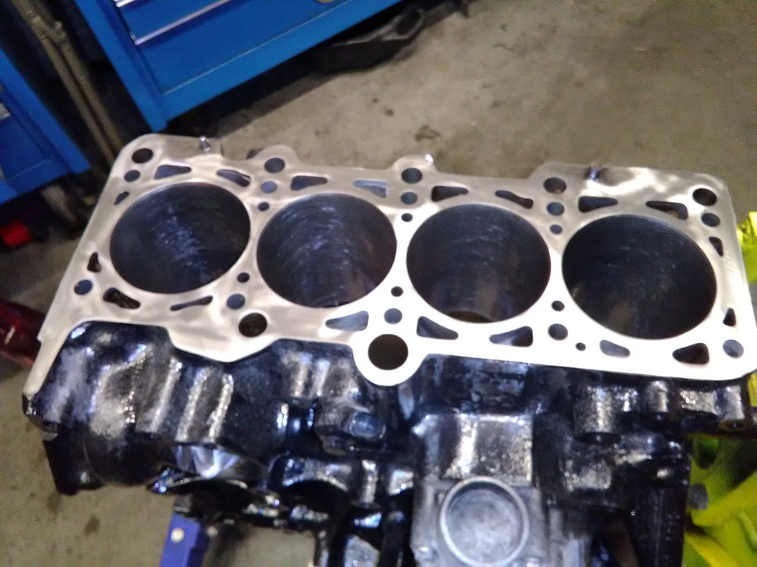

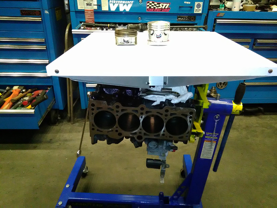

    Follow up tear down and cleaning..........lite hone and decks von 3M cookie.
    Cross hatches fast .......good good Ja ja....
    Lower deck cookie time......ja
    cookie good enough now time to get tanked.......
    Dress for pause to retain measurements stop corrosion.....bla bla
    Time to start custom bore, offsets....stroke shaving rod length... plus ring gaps on fly because nothing in here will belong going forward in this carcass coming back from the dead.

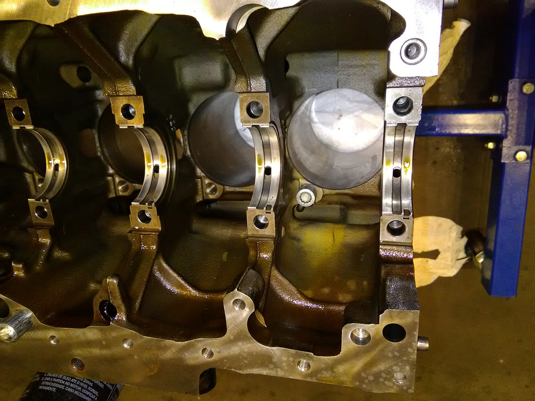

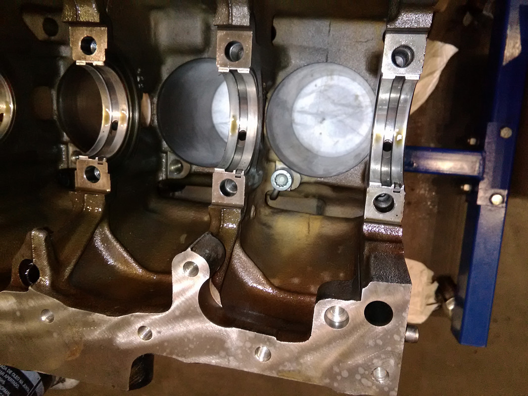

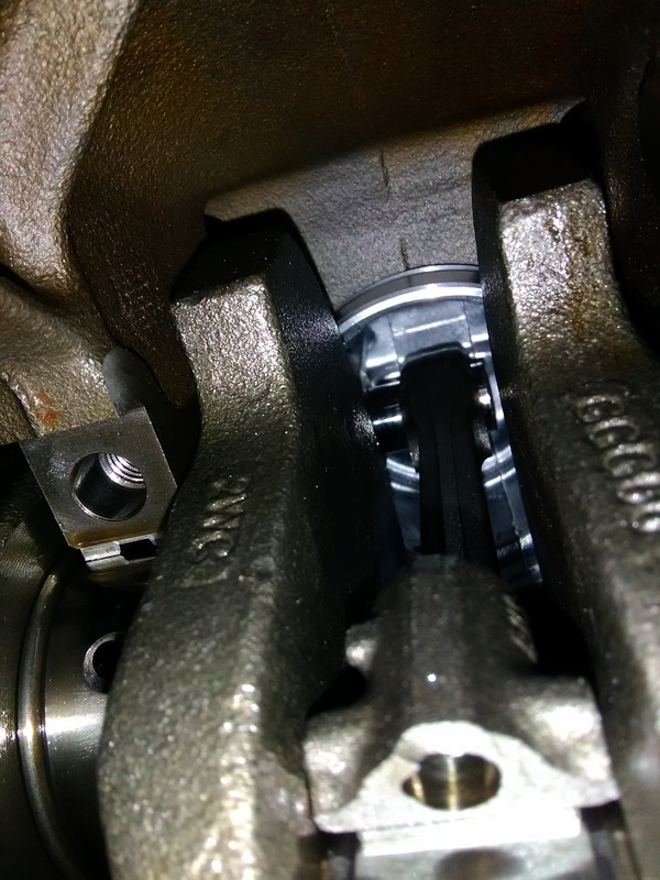

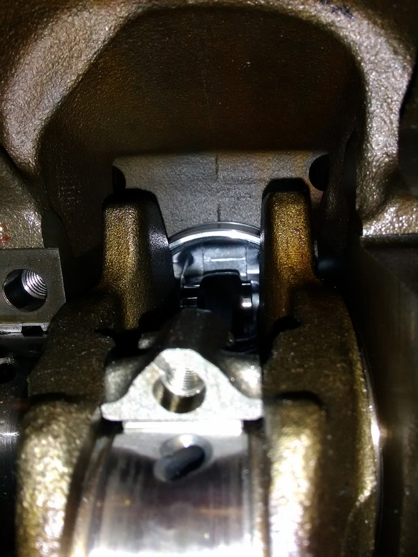

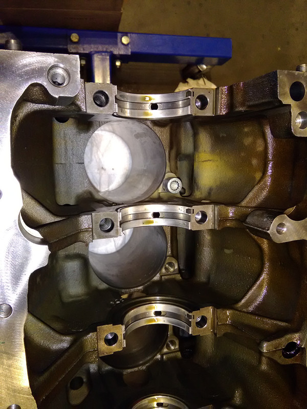

    Before I do anymore cleaning I'm taking some measurements & comparing data to surmise what I'm going to shave, sleeve or add....
    As can be seen with the 2.0 crank, the crank hits the skirts and makes way to show lower oil ring.
    This would be unacceptable.
    Deck is also not ideal at current settings and unacceptable for 2.0 crank + rod.
    A 1.8T crank also again reveals too much above deck as can be seen below.
    Clearance of the skirt to crank is possible on 1.8T crank as can be seen below still issue for lower oil ring.
    Piston compare of 2.0 to donor to be mangled to fit for perspective.
    It is my opinion that the short skirts of the pistons may be better for high rpm and weight reduction, however, they are not useful in an RPM that would aid useful life or power to create clarity of combustion and are short lived, history also shows us this.
    What I clearly see is skirt slap and rings wearing on an angle due to chatter resonance from piston not being held in bore consistent, they are susceptible to carbon and pitting as a result hence blow by!
    Talk about planned obsolesce.....
    The rings are indeed with carbon, pitting and pistons with skirt slap burns.
    It is with these small surface area contacts, the rings in contact with bore, fail to seal proper and permit oil into combustion process or fuel and gasses into the sump.
    Considering a turbo motor will just blow the gasses into the sump, I see a huge advantage here in weight follow through inertia and the seal of the chamber even if I deleted the lower ring.
    Now I may have to grind the skirt of this piston or add a sleeve to block and this is all entirely possible.
    Considering other custom settings and hardware in my thoughts with junk.
    It's more fun to use stuff already in production and mod it or cross it to do what you want and sure is cheaper.

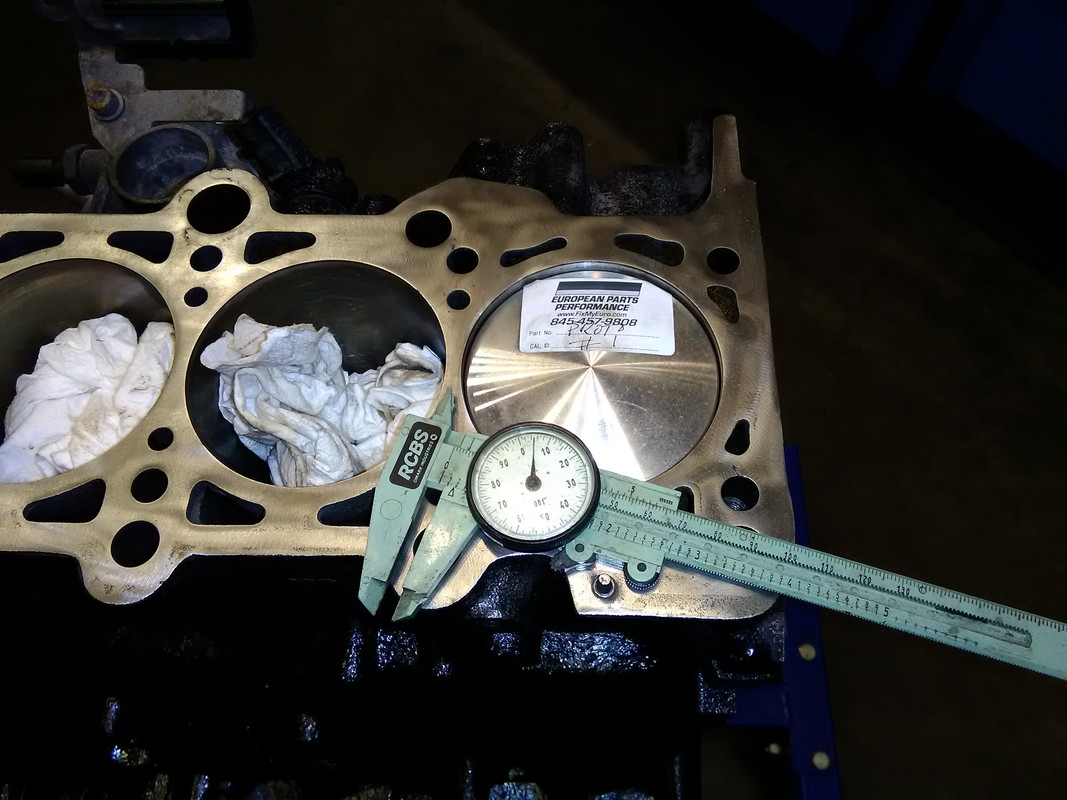

    Diff rods indeed permit a different rock point of 2.5 MM
    Believe it or not the center of that dome piston is above deck by .75MM
    Yeah things would be extremely tight on bottom end too and that lower ring will get NIX'd
    Still de-stroked ......
    Could in theory still take advantage of larger ring sealing surfaces and extended skirt length for inertia to prevent resonance slap.

    I am slightly confused where you have got to at the moment. Looking at the last image, is a longer rod and a shorter stroke crankshaft a possibility to keep the bottom ring lands in the cylinder and reduce the piston projection from the deck? What about easing the piston skirt where you have the crank webs fouling, so you have a slight slipper piston effect but the thrust faces are the same length, which is I think what you consider important?
    Regards HMC
  9. #47
    19,581
    That's the plan indeed.
    I am in process of getting another crank with even shorter stroke and going longer rod, that was where I left off waiting for parts from freight still held up.
    I want to see what a 1.4 will reveal at 80 and maybe try 140mm rods vs current 136mm
