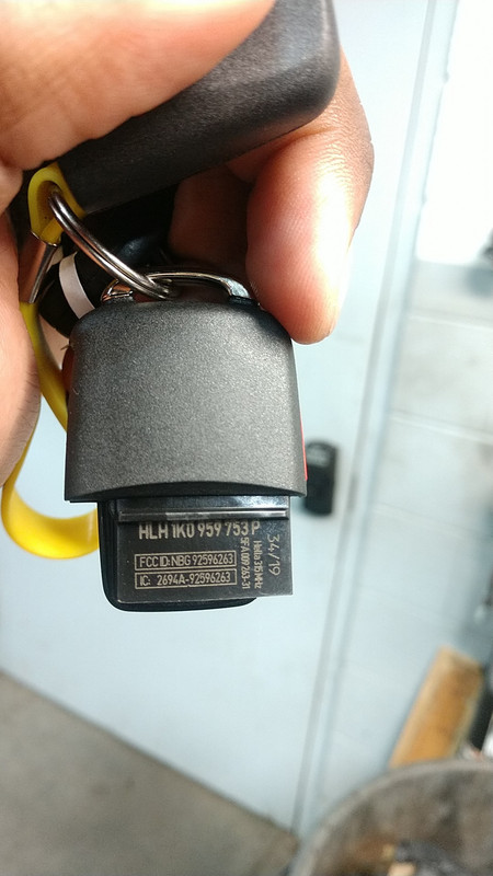

    Yeah well how about a picture of forward key section not remote?
    Find-lay Jokeswagen huh?.........
    Supersession
    PART NUMBER RIGHT DESCRIPTION REMARK MODEL
    1T0 837 246 C INB main key with change code
    transponder for radio control
    central locking system
    (folding key shaft, FOR
    rectangular key pad)
    inner profile
    Vehicle intelligent genuine part.
    Order only with additional instructions.
