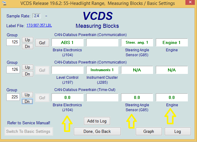

Time-Out meaning / reference in MBlocks
MVB_
Feb 16, 2015
161
130
C?ID=164610
Trying to find more info on the MBs meaning.

Hello,
Based on some research, I was able to find this information:
Message traffic is normally cyclical with prescribed cycle times.
This ensures that the messages are transmitted in good time.
If there are delays, it means that at least ten messages are not received and this triggers the message timeout
This causes a entry in the fault memory of the receiving control unit.
This is the second element of the error management system. The following error messages are available for in-service diagnosis:
1. Data bus defective
Fatal errors were detected in the affected control unit.
The control unit disconnected at least twice from the bus (bus off).​
2. Missing messages from .... or no communication with the affected control unit.
Messages are not received in good time. Timeout monitor responded​
ref:Glossary
Message timeout
- Time monitor that monitors transmitted messages on receiver side
Source: VW/Audi - Self-Study Programme 238, Data Exchange On The CAN Bus I, pg.25
This and other useful information can be found in the Official Factory Repair Information
Hope this helps,
drpeter
