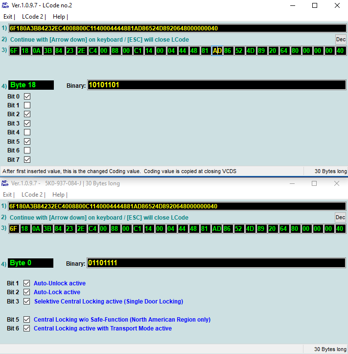

    13 Tiguan LED Bulbs
    Hi my bulbs started burning out so I replaced all the rear bulbs with Sylvania LEDs (Brake, Turn Signals, Parking, Tail, Back-up and Plate).
    I was able to find on Byte 17 to disable Licence Plate Lights Pulse Width Modulation
    However I am still getting bulb out for the others. I saw a few posts similar on other models and they all say to go to Byte 18 to turn off Cold Diagnosis. When I go to Byte 18 on mine all it shows is NAR, however I noticed if I go to LCode no.2 Byte 18 looks similar to screenshots of others but there is no text next to the Bits.
    So my question is there a way to turn on text in LCode no.2 if not, are these options the Cold Diagnosis toggles?

  2. #2
    Jun 2014
    159
    Don't play around with byte 18 if you don't know what you are doing! Lots of people messed things up by changing byte 18.
    Start with fixing Ignition switch...

    This ^
    And do all bulbs serve a dedicated function, or does (for example) some tail light bulbs double as brake light? In that case, PWM is the only way to realize that function, and you might want to have a second person in the car operate the lights while you visually observe if everything functions as it should, especially brightness difference between tail lights and brake lights.

  6. #4
    Aug 2019
    Quote Originally Posted by MasterTommy View Post
    This ^
    All the bulbs functions just fine, they are dimmer for tail lights and brighter for brake/turn.
    I am just trying to turn off the Cold Diagnostics so that I can stop the bulbs flickering when starting the car and get rid of all the annoying messages on the dash.

  7. #5
    Jan 2015
    Bosnia and Herzegovina
    545
    this can be done with vcp (reading and modifying eeprom values directly), not with vcds, trying different values for byte 18, experimenting, can brick your bcm...
