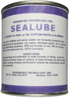

    Preventive maintenance......beware of your ethanol?
    Seal lube or Vaseline.........
