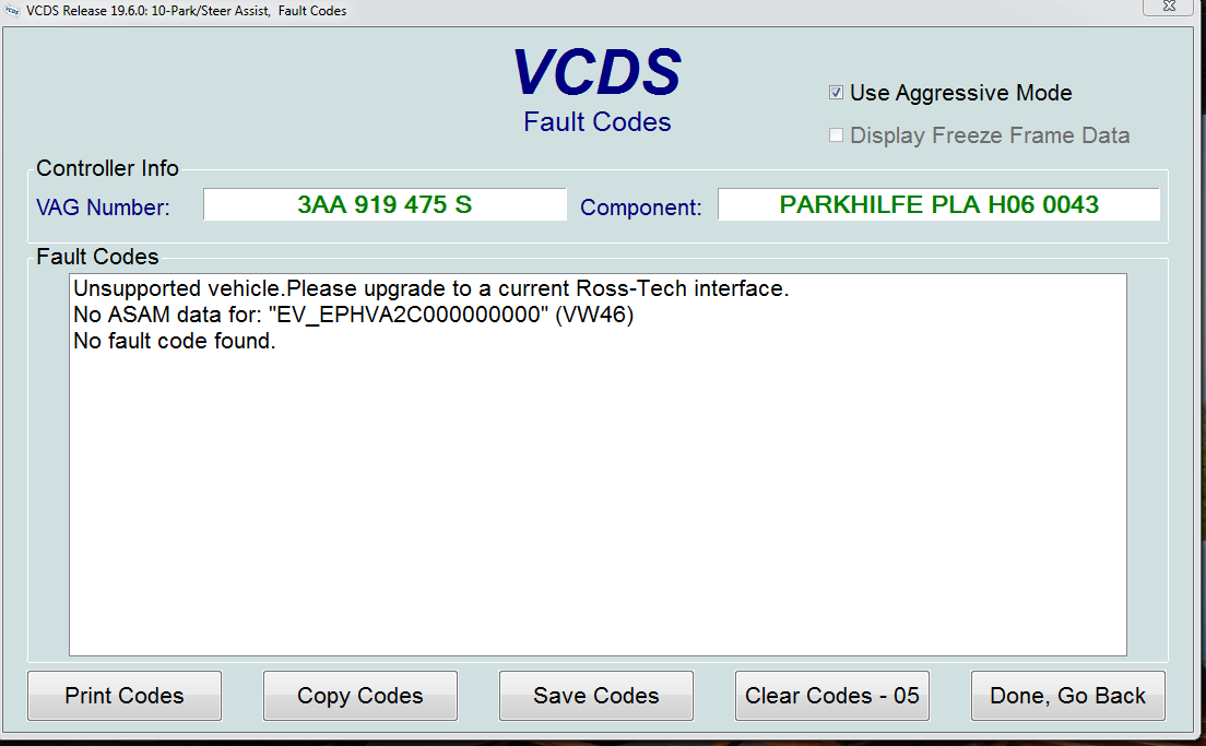

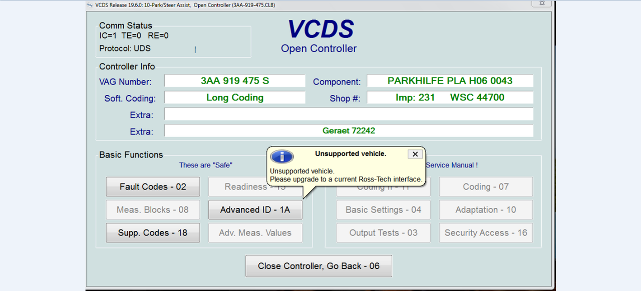

    Hello there , after vcds new release 19.6.0 i can not have further Access in PLA 2.0 , i am sending you a full autoscan and some photos .

    Interesting; it finds the ASAM data just fine during the Auto-Scan:
    Address 10: Park/Steer Assist (J791)       Labels:| 3AA-919-475.clb
       Part No SW: 3AA 919 475 S    HW: 4H0 919 475 E
       Component: PARKHILFE PLA H06 0043
       Revision: --------    Serial number: 56261331200406
       Coding: 340101
       Shop #: WSC 44700 231 72242
       ASAM Dataset: EV_EPHVA2C000000000 002014
       ROD: EV_EPHVA2C000000000.rod
       VCID: 4B953CA0E253B71734-801E
    Is this module a retrofit or is it original to the car?

    OK, I'm sure some kind of fix or work-around is possible.
    What happens if you do an Auto-Scan first, then access this module without exiting VCDS?

    Quote Originally Posted by 4WDDSG6 View Post
    what do you mean exiting VCDS?
    Do an Auto-Scan first. Then try to access the module without closing or exiting VCDS.
    I think this is a question whether VCDS knows the VIN of your car at the time you access this module. If you close VCDS and re-start it and go directly to the module, it may not know the car's VIN at that time.

    Hello again, I did exactly what to told me but nothing happens .
    I think that is time to fix this problem by the Ross tech experts .
    Regards

    So no error message when you access the module after doing an Auto-Scan first?
