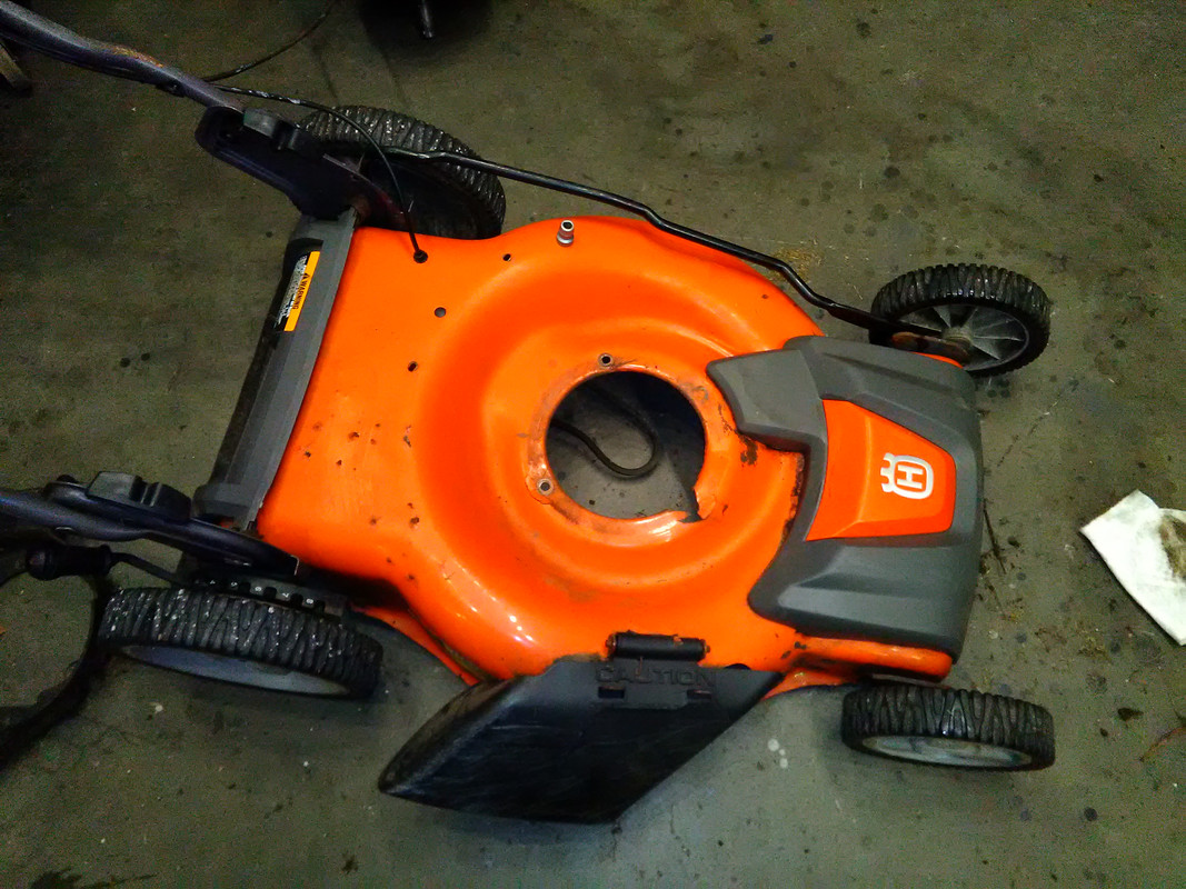

    This issue with the steel on decks of these mowers failing on lawn tractor or push type mowers is pervasive huh?
    After having to weld up a few for people and now two of my own and one for my brother & not too long ago, I see a pattern behavior warranted of a safety recall or class action, how about you?

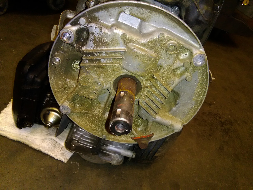

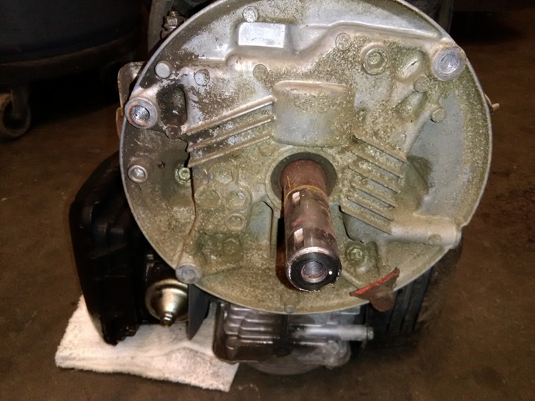

    PICTURE TIME............
    REMOVE ENGINE TO INSPECT DAMAGE AND WTF HAPPENED AND WHY!

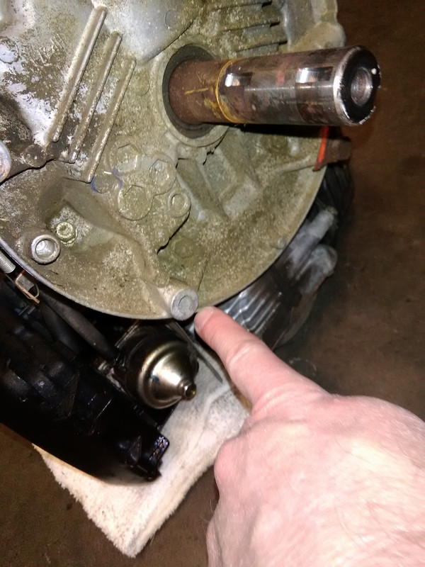

    SURMISE CRACKS START GRINDING AND SEE BOLT SHADOW WTF

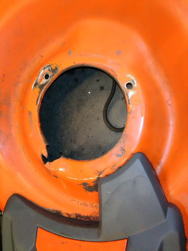

    INSPECT ENGINE HOLE AND IS NOT THREADED BUT GOES THROUGH AND CAN BE NUTTED WITH BOLT IF HOLE DRILLED.
    REMOVE EAR TO GRIND DEBURR AND FIT THE PUZZLE PIECE.
    PUZZLE PIECE MISSING i GUESS WE WILL FILL IT AND REINFORCE UNDERSIDE & DRILL NEW HOLE!

    FILL PUDDLE FOR MISSING SECTION & GRIND THE DECK!
    IT'S A LAWNMOWER PAINT AND IT'S A WRAP!
    ONE EXTRA BOLT NOW!

    This happened because they didn't triangulate the mount point's of motor to deck or have a lip to marry the engine to deck.
    Just no sense at all!
