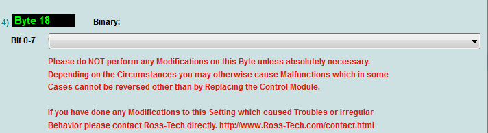

    Unfortunately, it is not accessible to VCDS. It's really quite nasty the way they did this.
    Than itís nasty for sure, and i agree with PetrolDave about a warning box so that other vcdsírs donít make the same mistake.
    I know that any changes are anybodyís own risk, but in this case an extra warning could be welcome

    Than it’s nasty for sure, and i agree with PetrolDave about a warning box so that other vcds’rs don’t make the same mistake.
    I know that any changes are anybody’s own risk, but in this case an extra warning could be welcome
    This isn't sufficient?
    I think Your coding is so messed up. I think You could try:
    48180A3A6001C790400800C0500081E44F7002884321C9206480A0200040
    If doesn't help, revert to original.
