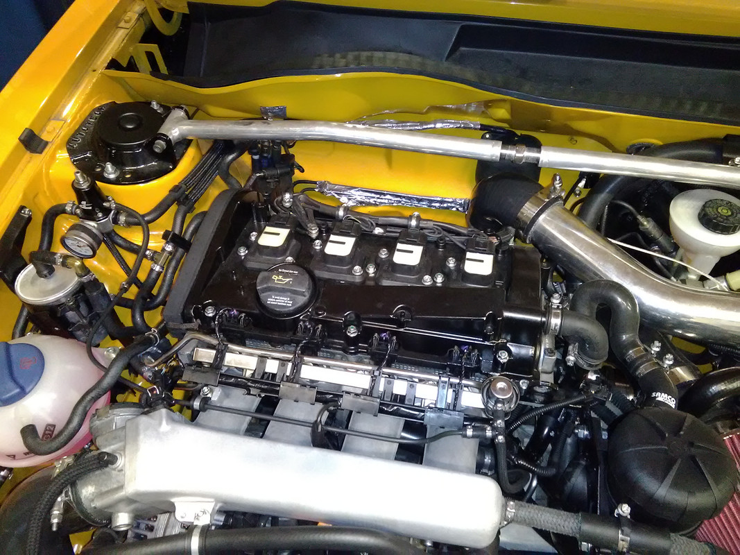

Am I hallucinating or is that a K&N type filter peeking through in those pics?
   #26
Jack@European_Parts
Gone But Not Forgotten
21,923
9,308
Montgomery, NY, USA
C?ID=57337
You are not hallucinating & I know you know it would never be my choice right?

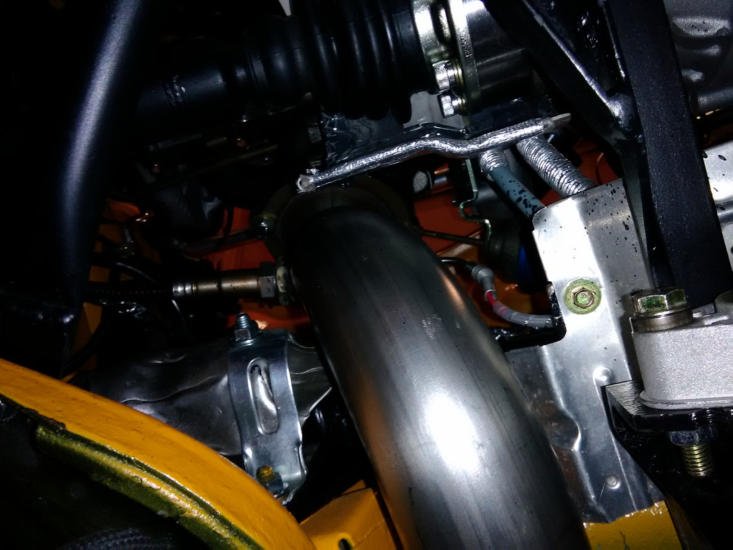

Welded barb on down-pipe for EGT that came in.
Installed harness with spiral wrap and secured for floating strain relief at rack with tie wrap.

Getting there now..........
Fuel system activated!
PSI test hold 1 week statics, check!
Secondary FPR and hold + increasing loads, check!
Custom metal line sent from FPR to strut tower FPR compete with float for chafe verified.
EGT gauge landed in dash.....Historic digit type + cutting and type to match era.
