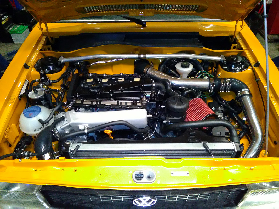

    Well I'm here working on Scirocco 77 Off Road project and sorting the tower of coolant, fuel and EVAP.
    This is in development and mock up mode to test fit every custom part.

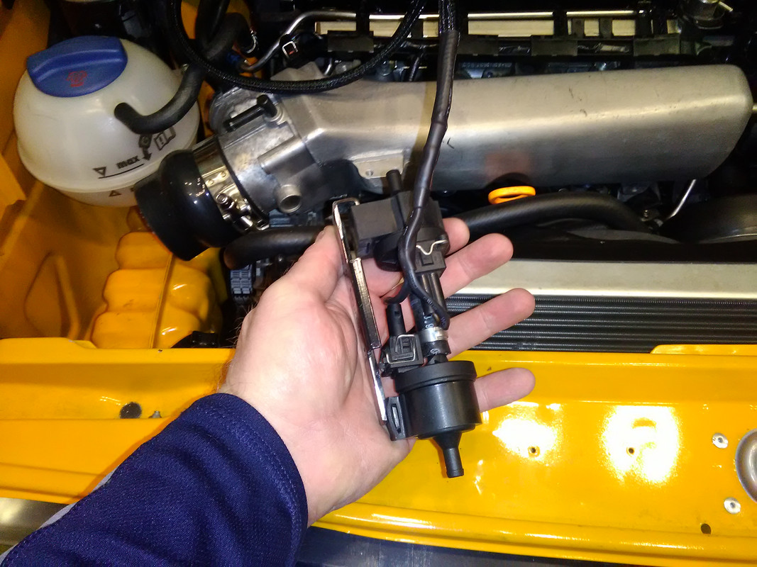

    NostraJackASS roots from a poor up bringing & to always improvise.
    I'm such a scavenger...........Got to love those old ECU tamper proof brackets being re-purposed.
    A slide it in fit for easy change too.
    Checking fitment in area to be mounted.......
    So tests show under boost the valves setup this way switch at idle & as specified by ECU and are capable of holding back my shop air of 175 PSI @ 200 CFM, now that is impressive!

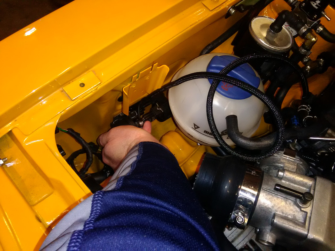

    More fabrication commencing..........
    Bracket built painted and mounted for dual N80's, now building a new bracket to rad support for strain relief of pulses and add the mechanical check valve for redundancy from Intake at TV.
    Well landed in support clean.....yay!
    Now some trimming and a clamp style change I think & since puts crimps as jam device......ahhh who knows in process!
    Fuck it...... back to aviation style clamp and shorter.
    Going to change hose to intake too slightly larger diameter braid too.......
    Yeah I like that better!

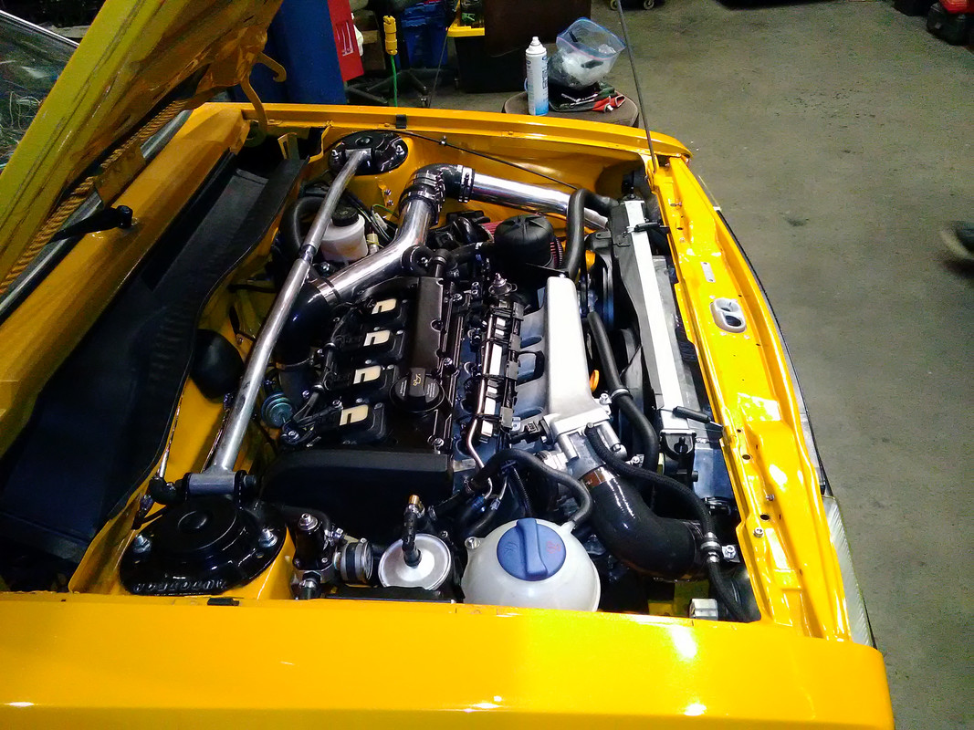

    Starting to look like something now.........
    Going to have to remove intake and take out oil PSI big VAG tester gauge.
