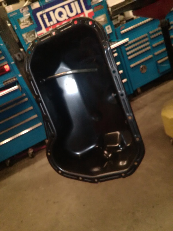

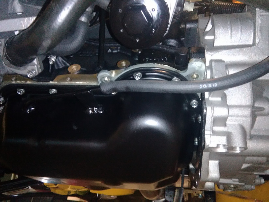

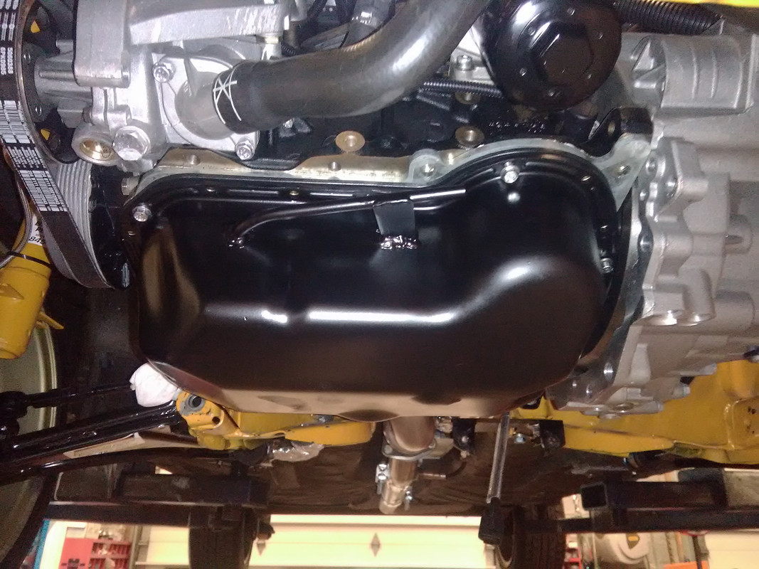

    SAT update........SUMP MOD!
    Pro vent drain to SUMP add addition with pipe to integrated baffle labyrinth in oil pan "grid" trap door design not shown.
    Run and route hose from Provent in process still for additional two brackets TBD @ Trans case.
    Start FAB on the fly........
    REMOVE lower stress bar and dog bone drain oil and remove turbo return line.
    REMOVE PAN FOR QT INSPECTION OF GIRDLE AND OIL QUALITY & TOO VACATE ASSEMBLY PASTES. CHECK!
    DRILL HOLE IN PAN AND BEND PIPE LEFT OVER FROM CHINA TOILET PAPER HOLDER & TO MAKE USE OF SCRAP WHICH IS NOW A RACE CAM BRAKE ROTOR TOILET PAPER HOLDER.
    WELD IN PLACE FREE HAND BRACKET TO HOLD FOR VIBRATION.
    MIGHTY VAC THE LINE AFTER WELD AND PAINT ....CHECK!
    INSTALL PAN TEST FIT WITH GRID .....CHECK
    VERIFY RETURN LINE AND CUT TO ESTIMATE ROUTING FROM MANN PRO VENT........CHECK.
    LAND FASTENERS......
    HOSE TYPE DOUBLE BRAIDED ATF AND DIESEL TYPE TO NOT REACT!
    THAT'S IT FOR TODAY......BEAT!

    Mock/Weld up, painted landed Mann pro vent brackets to sump at Transmission/starter location for chafe at starter solenoid/lower radiator hose during motor TQ solved + for resonance solution.
