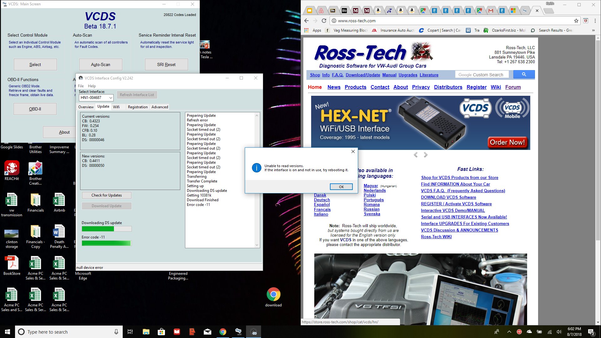

Can you post a screenshot of the updates tab in VCIConfig?

I don't know how to post images to this thread. How do I do it?

Dkk3sYEUYAADXOp.jpg:large
Is that what you needed?
Dana
6,018
9,022
Western PA, USA
Yep, that's exactly what we needed. It looks like the SD card is failing and those are specially formatted so we need to send you one.
