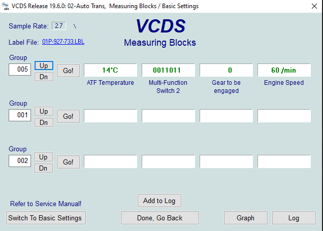

    There's a hill in my neighborhood. If I attach my UltraGauge Blue and drive up and down the hill, the transmission temp gauge I defined moves gradually up and down by 2 degrees F. If I drive the same course with my expensive laptop teetering on the back seat to record a log from my expensive HEX-NET I get the following log: https://docbucketjmb.s3.amazonaws.co...05-xxx-xxx.CSV which pretty much only toggles between 68C and 80C.

    OK, that doesn't seem right. What does it show when the transmission is cold (ambient temperature)?

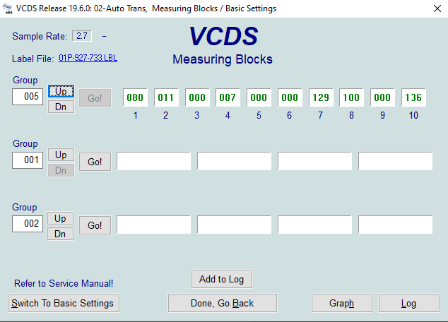

    I stumbled on a discovery. VCDS works better if it gets an assist from UltraGauge. If I first connect my UltraGauge and then yank it and connect VCDS/Hex-Net, the VCDS GUI makes more sense and its log makes more sense. Here is the GUI without and with an assist:
    I've already provided a no-assist sample of a VCDS log. Here is a log after an assist: https://docbucketjmb.s3.amazonaws.co...ith-Assist.CSV The values gradually increase from my garage's ambient temp.
    I was hoping I would see some improvement in the VCDS-mobile/Hex-Net configuration after an UltraGauge assist, but I didn't.

    What are your PC specs?
    I tested VCDS on our Eurovan here and my VCDS looks identical to your second image. The Measuring block values match between HEX+CAN and HEX-NET: https://drive.google.com/file/d/1nKX...ab3-wiMxc/view.

    I wasn't able to reproduce my results this morning either. Second image in each case.
