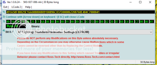

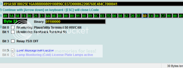

    When I added LED licence plate lights to my PQ35 based Octavia (1K0 937 087 Q) I had to check byte 17, bit 7 to remove the bulb out warning. It also stopped the cold diagnostic light check disco when unlocking the car.
    Byte 23, bit 6 was checked from factory and still is.

    Gary,
    I found the same screen as you...
    Would the Bit 5 be something that if unticked, would allow non Can led lamps to be used?
    It seems to be 'grouped' with Bit 6.
  5. #24
    26,477
    Quote Originally Posted by jasons6930 View Post
    No, Load Management has nothing to do with what light bulbs are acceptable to the module; it determines whether loads are shed as the battery's state-of-charge depletes.
    The only reason those two appear "grouped" is because bits 4 and 7 are undocumented and thus blank.
    No, "Load Management" is something completely unrelated to the lighting. If Bit 5 is activated (as it currently is), that setting causes certain control modules or components to be put into a type of power saving mode to try and preserve some power if the battery voltage falls below a defined Low Voltage Threshold (LVT) value.
    Bit 5 isn't actually "grouped" with Bit 6. It's just that there is no Bit 4 (or Bit 2 either) so it is an optical illusion that makes it look like some of the tick boxes are grouped together when they are all actually individual entities.
    EDIT: Looks like Uwe already answered the question. I was far too slow completing my reply and pressing the submit button
