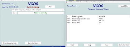

Quick update, I replaced the Climatic unit with one from a donor vehicle. Same P/N, same SW, it even had the same coding. Just a few months newer.
No change in behavior. Still getting a maximum blower load of 74.4% at 10.1v.
I can now force an output test at 12.5v and it shows 100% blower load. There is noticeably more airflow.
Is this just the way it's programmed from VW?
Edit: Forgot to add that during the automatic compressor run-in procedure, the blower automatically ramps up to 100%

Log it while driving to see if the logic is limiting system draw since the alternator is only at idle speed.

See attached graph, including engine RPM, fan load and specified blower value. The climate controls are set to Max AC, "6" max fan speed, AC On, Re-circulation On.

I've gone through the guide, downloaded Alligator, and have scanned the 08 HVAC Controller. This is all that's returning:
Engine Running / HVAC Off:
;SW:561-907-426-G   HW:561-907-426-G ---  08: Auto HVAC
;Component:AC Manuell    H03 0506, Coding:0010001002
;EV_ACManuaElectGen2BHTC,001002,EV_ACManuaElectGen2BHTC_VW36.rod
;Friday,25,September,2026,12:28:44:10126
;VCDS Version: 26.9.0.3 (x64)  Data version: 20260918 DS378.0
;VCID: 1F1C03CC673FA412FEA-804A
Group,Description,Actual
IDE00019,Voltage terminal 30,13.1, V
IDE00021,Engine speed,600, /min
IDE00025,Coolant temperature,102, °C
IDE00075,Vehicle speed,0, km/h
IDE00198-ENG100282,Refrigerant pressure-MUX Kaeltemitteldruck,7.8, bar
IDE00325,Diagnostic mode,VW - diagnostic mode,
IDE00767,No. of unscheduled ECU resets,255,
IDE00965,Compressor shut-off condition,A/C off or fan control switch in 0 position,
IDE00967,Compressor current: specified value,0.000, A
IDE00968,Compressor speed,0, /min
IDE00969,Compressor load,0.0, Nm
IDE00970-ENG103807,Coolant fan activation: actual value-MUX Lueftersteuerung,29.2, %
IDE00971,Coolant fan activation: specified value,0.0, %
IDE00972,Idle speed increase,not active,
IDE00973-ENG100004,Outside temperature-MUX Temperatur,29.0, °C
IDE00974-ENG100004,Outside air temperature internally calculated-MUX Temperatur,22.0, °C
IDE00982-ENG103939,Temperature downstream of evaporator-MUX Temperatur nach Verdampfer,33.7, °C
IDE00987,Blower voltage: specified value,0.0, V
IDE00988,Front fan load,0.0, %
IDE00989,Blower status,OFF,
IDE00990-ENG103832,Dimmer signal-MUX Dimmungswert,0, %
IDE00991,Vehicle variant,Offroad,
IDE00992,Recirculation flap specified value,100.0, %
IDE00993-MAS00069,Status of input signals 11-Not assigned,OFF,
IDE00993-MAS01277,Status of input signals 11-Rear window heater actual value,OFF,
IDE00993-MAS01278,Status of input signals 11-Rear window heater target value,OFF,
IDE00993-MAS01279,Status of input signals 11-Auxiliary heater actual value,OFF,
IDE00993-MAS01280,Status of input signals 11-Coolant temperature increase,OFF,
IDE00993-MAS01281,Status of input signals 11-Back-up lamps,OFF,
IDE00993-MAS01282,Status of input signals 11-Wiper,OFF,
IDE00993-MAS01283,Status of input signals 11-Actual value of windshield heater,OFF,
IDE00993-MAS01284,Status of input signals 11-Target value of windshield heater,OFF,
IDE00993-MAS01293,Status of input signals 11-Auxiliary heater target value,OFF,
IDE01046,Temperature flap: actual value,21,
IDE01047,Temperature door - Specified value,0.0, %
IDE01048,Temperature flap: cold stop,21,
IDE01049,Temperature flap: warm stop,227,
IDE01058,Country coding,USA,
IDE01059,Air distribution flap: actual value,80,
IDE01060,Air distribution flap: specified value,21.5, %
IDE01063,Status of recirculation air,Fresh air,
IDE01066,Convertible top status,Closed,
IDE01076,Time since ignition off,1, min
IDE01094,Air distribution flap: defrost stop (via defog),22,
IDE01217,Left heated seat stage,0,
IDE01218,Right heated seat stage,0,
IDE01287-MAS01260,Counter of compressor switch-offs-Shut-off from Engine Control Module (ECM) via CAN,7252,
IDE01287-MAS01265,Counter of compressor switch-offs-Speed shut-off,1,
IDE01419,Compressor shut-off condition: last,Outside temperature too low,
IDE01420,Compressor shut-off requirement: penultimate,Switch-off due to energy management,
IDE01421,Compressor shut-off requirement: antepenultimate,Outside temperature too low,
IDE02304,Air distribution flap: defrost stop (via upper body outlet),291,
IDE02472,Air-conditioning operation information,not active,
IDE02487,Override of stop for air-conditioning settings,Stop release,
IDE02492,Start/Stop Function: coding information,Start-stop function in control module not active,
IDE03008,Stop process prevented,Stop release,
IDE03008,Stop process prevented,System malfunction,
IDE03009,Start process requested,Stop release,
IDE03009,Start process requested,System malfunction,
IDE03010-MAS02800,Number of prevented stop processes-Maximum cooling selected,0,
IDE03010-MAS02801,Number of prevented stop processes-Maximum heating selected,0,
IDE03010-MAS02802,Number of prevented stop processes-Interior temperature difference to specifications,0,
IDE03010-MAS02803,Number of prevented stop processes-Interior vent difference to setting,0,
IDE03010-MAS02804,Number of prevented stop processes-Manual fan speed increase,0,
IDE03010-MAS02805,Number of prevented stop processes-Fogging hazard (calculated),0,
IDE03010-MAS04353,Number of prevented stop processes-Fogging hazard (humidity sensor),0,
IDE03010-MAS04354,Number of prevented stop processes-Interior comfort humidity too high (humidity sensor),0,
IDE03010-MAS12897,Number of prevented stop processes-Defrosting active / front windshield defogging,0,
IDE03011-MAS02800,Number of requested start processes-Maximum cooling selected,0,
IDE03011-MAS02801,Number of requested start processes-Maximum heating selected,0,
IDE03011-MAS02802,Number of requested start processes-Interior temperature difference to specifications,0,
IDE03011-MAS02803,Number of requested start processes-Interior vent difference to setting,0,
IDE03011-MAS02804,Number of requested start processes-Manual fan speed increase,0,
IDE03011-MAS02805,Number of requested start processes-Fogging hazard (calculated),0,
IDE03011-MAS04353,Number of requested start processes-Fogging hazard (humidity sensor),0,
IDE03011-MAS04354,Number of requested start processes-Interior comfort humidity too high (humidity sensor),0,
IDE03011-MAS12897,Number of requested start processes-Defrosting active / front windshield defogging,0,
IDE03127-IDE03008,Prevented stop processes (ring memory)-Stop process prevented,Measuring value not available,
IDE03127-MAS00106,Prevented stop processes (ring memory)-Year,2127,
IDE03127-MAS00107,Prevented stop processes (ring memory)-Month,15,
IDE03127-MAS00108,Prevented stop processes (ring memory)-Day,31,
IDE03127-MAS00109,Prevented stop processes (ring memory)-Hours,31,
IDE03127-MAS00110,Prevented stop processes (ring memory)-Minutes,63,
IDE03127-MAS00111,Prevented stop processes (ring memory)-Seconds,63,
IDE03128-IDE03009,Requested start processes (ring memory)-Start process requested,Measuring value not available,
IDE03128-MAS00106,Requested start processes (ring memory)-Year,2127,
IDE03128-MAS00107,Requested start processes (ring memory)-Month,15,
IDE03128-MAS00108,Requested start processes (ring memory)-Day,31,
IDE03128-MAS00109,Requested start processes (ring memory)-Hours,31,
IDE03128-MAS00110,Requested start processes (ring memory)-Minutes,63,
IDE03128-MAS00111,Requested start processes (ring memory)-Seconds,63,
IDE03212,Start/stop conditions,Stop release,
IDE03213,Start/stop enable,System malfunction,
IDE03214,Engine stop using start-stop function,not active,
IDE03215,Engine start using start-stop function,not active,
IDE04312-IDE04095,System run time-Engine running time,255, s
IDE04312-MAS00084,System run time-Terminal 15 on,255, s
Elapsed Time: 00:06
Engine Running, HVAC set to MAX AC w/ Recirc:
;Friday,25,September,2026,12:31:18:10126
IDE00019,Voltage terminal 30,12.8, V
IDE00021,Engine speed,700, /min
IDE00198-ENG100282,Refrigerant pressure-MUX Kaeltemitteldruck,15.2, bar
IDE00965,Compressor shut-off condition,Compressor active: no shut-off condition is present,
IDE00967,Compressor current: specified value,0.820, A
IDE00968,Compressor speed,900, /min
IDE00969,Compressor load,8.8, Nm
IDE00970-ENG103807,Coolant fan activation: actual value-MUX Lueftersteuerung,51.2, %
IDE00971,Coolant fan activation: specified value,64.0, %
IDE00973-ENG100004,Outside temperature-MUX Temperatur,28.5, °C
IDE00982-ENG103939,Temperature downstream of evaporator-MUX Temperatur nach Verdampfer,28.7, °C
IDE00987,Blower voltage: specified value,10.1, V
IDE00988,Front fan load,74.4, %
IDE00989,Blower status,On,
IDE00992,Recirculation flap specified value,0.0, %

Unfortunate this is done with fan stopped. So not much of a help, to maybe see a limiting condition. I think for me is sufficient. I tried.
beachVW
Sep 8, 2026
13
8
North Carolina, USA
C?ID=668365
I edited the post and included a second set of data with the AC on and both blower fan and cooling fans running. Did you see that? Is that still not sufficient?
