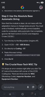

Update:
I took a chance and purchased a module and pump on eBay that the seller stated was from a car that had no ABS warning lights. All the numbers matched my original module. Installed and attempted my original coding and it would not accept as my original module was 18 bytes and this module was 19 bytes.
Found a sticky here explaining all of the modules for this generation and the bytes etc, but I did not understand it. I already knew this module had potential as it did not throw the implausible communication fault. I was using AI on google search to help understand a couple of the codes, and explained what I was doing.
It took about an hour of trial and error (at one point the module would not accept previously accepted long coding, and I was informed by AI that it required a "hard reset" which involved disconnecting the battery for ten minutes), and I uploaded a photo of the build sheet in the trunk as well, but AI configured the code for me based off of the build sheet and VIN. I hope this helps someone along the way.

Hello,
As long as the diagnostic VIN matches the car I believe the factory installed 03-ABS was: 1K0 907 379 BL @ 0152
The original coding string was likely the one in the first scan:
B14B200C512208FB8D0C04E48A1F1061A71000
The coding that's in there now lacks HHC and TPMS so I would code it back to the original 19 Byte string above. Clear all of the fault codes and post another scan in that condition please.
Nerdy Notes. VIN-less baseline:
1622013CBPAAT/09GL0L1K0 907 379 BL @ 0152B1002000510008008D0004008A001061A71000B12051088D048A1061A71000G1A0N9/0YC1N12UA1AS1ZQ/1KD

Seems like it's all fixed, thank you! Now on to see about improving the pedal travel.
