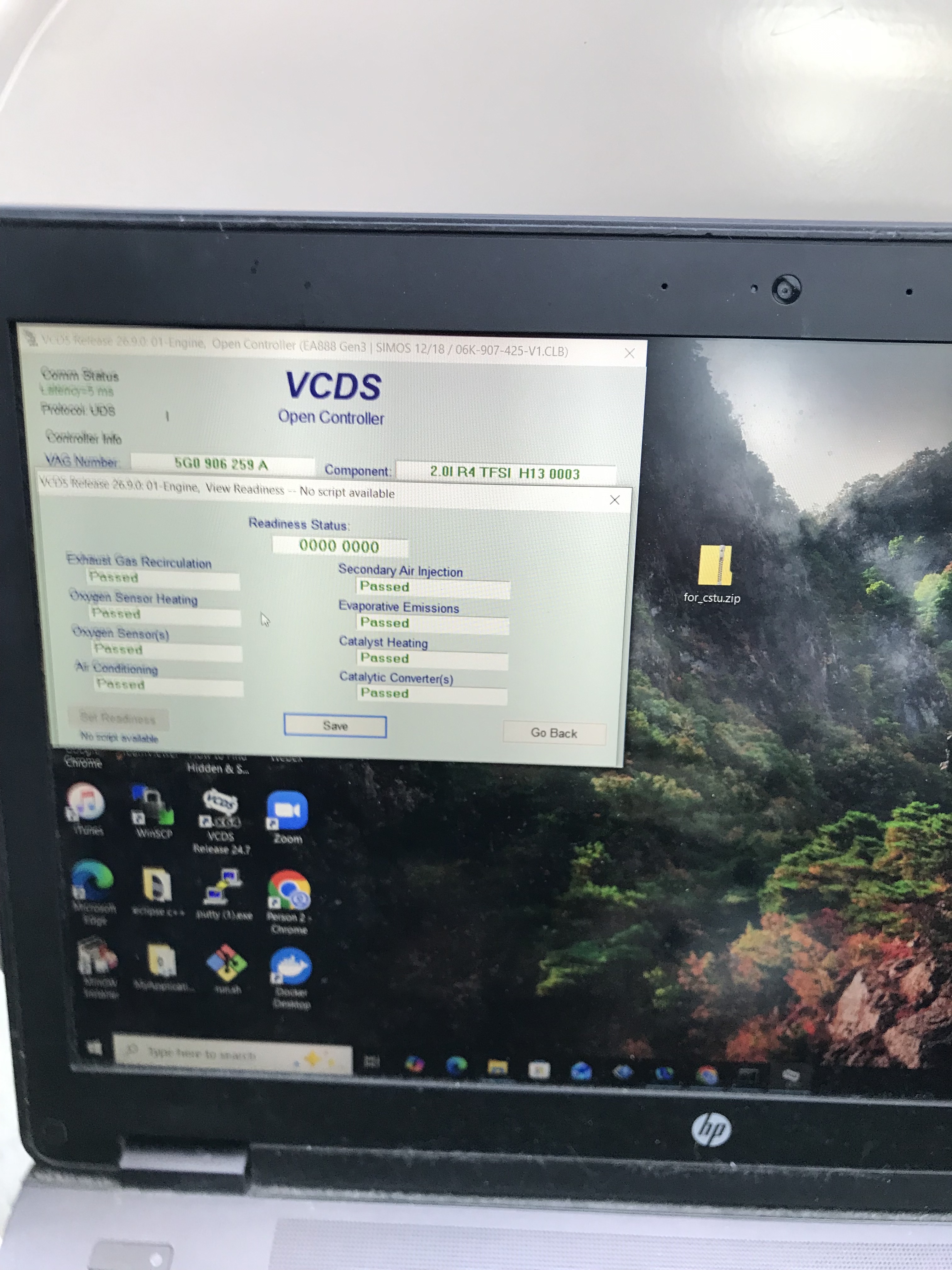

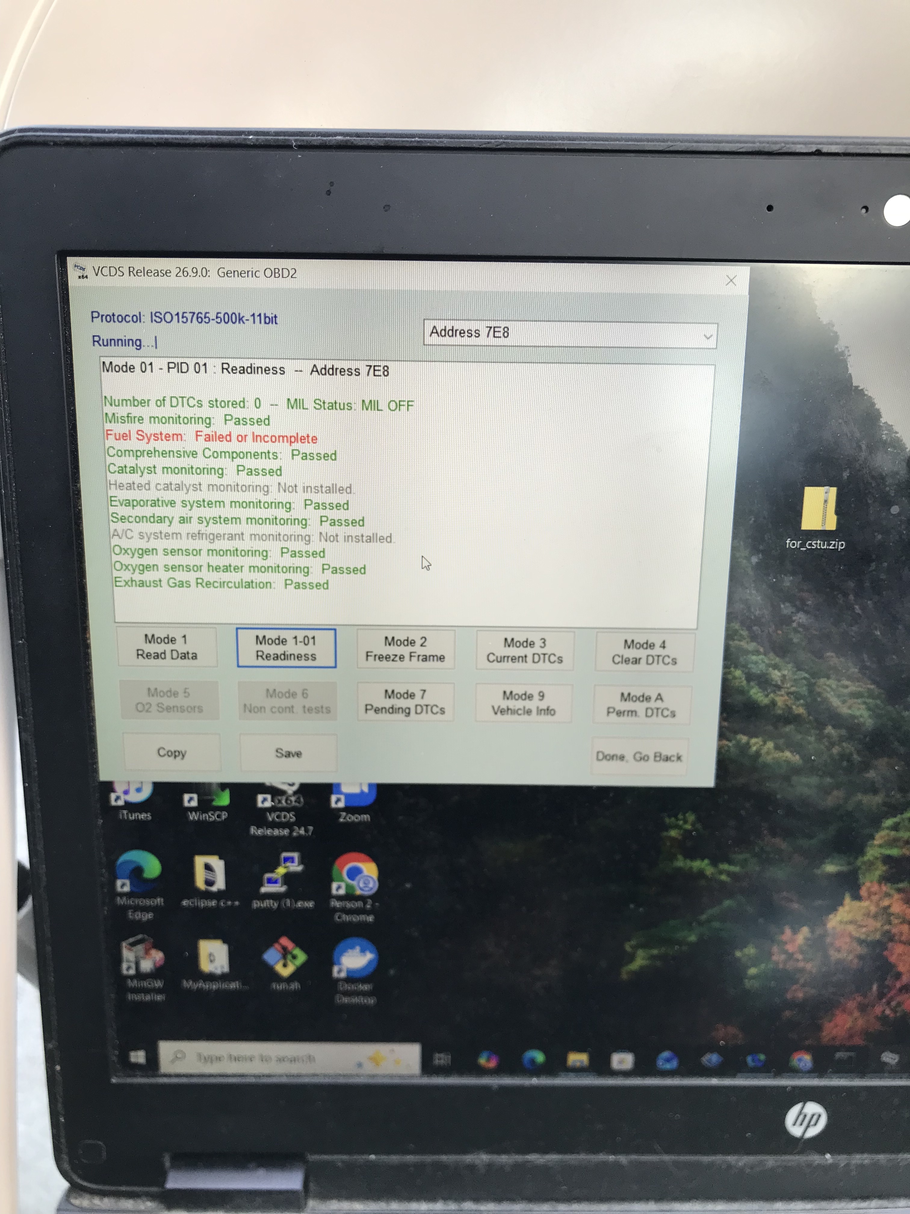

My 2015 GTI smog readiness from OBD2 scanner: 6 out of 9 ready, 3 not ready. Following are the not ready monitors:
Catalyst
Fuel
Oxygen
I have driven since reset about 30 miles, on highway and locals, still show stubbornly in OBD scanner as not ready, there us no code after scanning.
How long I should drive the car in terms of miles to get the above 3 monitors ready?

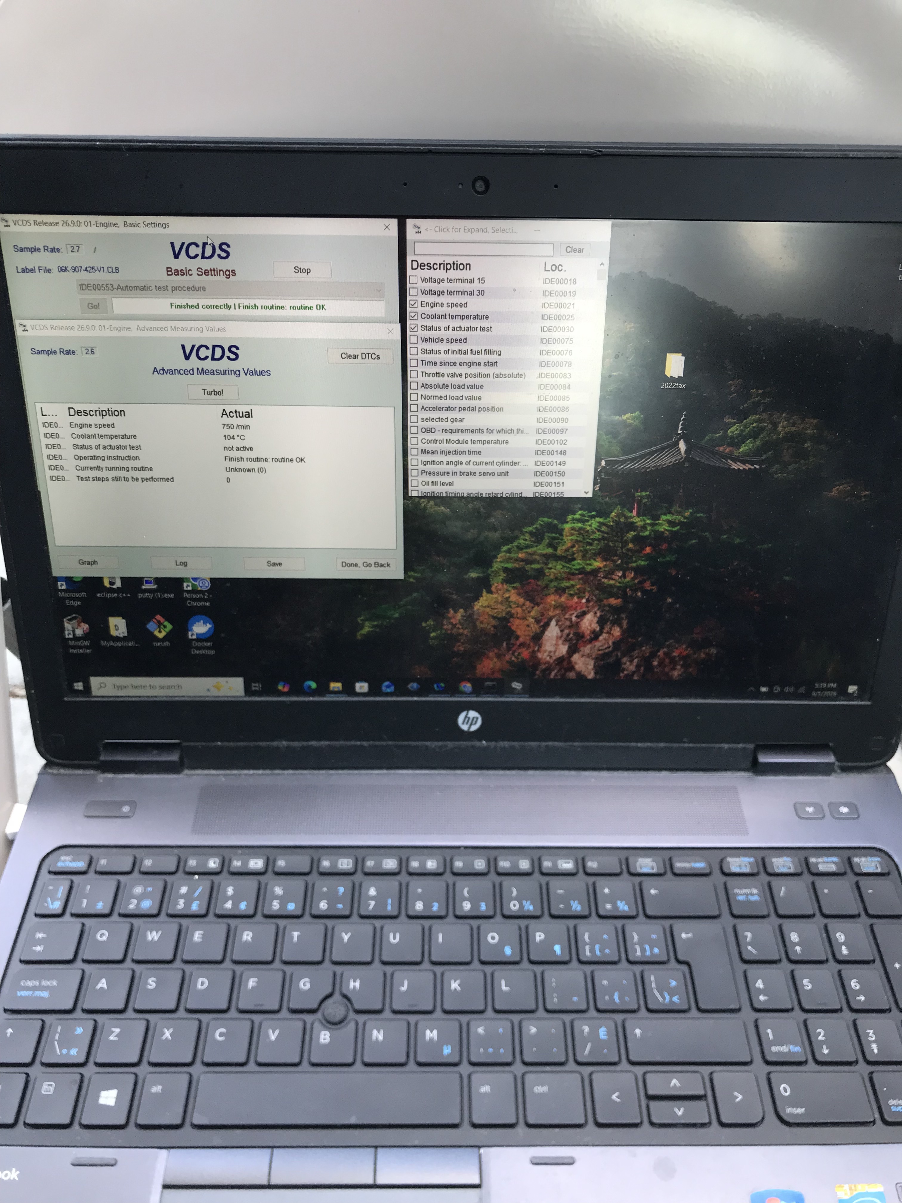

Thanks for the reply, there is no code.
ECU is stock ECU, never flashed after factory
There is no engine code, did a scan just now:

Readiness Status: 0010 0001
Exhaust Gas Recirculation: Passed
Oxygen Sensor Heating: Passed
Oxygen Sensor(s): Failed or Incomplete
Air Conditioning: Passed
Secondary Air Injection: Passed
Evaporative Emissions: Passed
Catalyst Heating: Passed
Catalytic Converter(s): Failed or Incomplete

Thanks Drpeter, I have run the Automatic Test Procedure under Basic Setting and show these measuring data, worked great
Test completed:
VCDS readyness show all of 8 monitors ready:
But OBD readyness still show Fuel monitor not ready:
It is highly likely that fuel system monitor was never included in the VAG proprietory 8 bit readyness vector, so Automatic test procedure will not test Fuel system monitor.

Why are you doing this in the generic OBD function instead of in address 01, readiness?
geyungjen
Jan 9, 2025
102
16
Fremont, CA, USA
C?ID=606828
Because I need to have the car pass California Smog Test that all OBD monitors are required to be ready for passing.

  • If STFT remains constantly positive (+10% to +15%): The ECM is having to add a significant amount of extra fuel in real time to compensate for unmetered air (a minor vacuum leak, unseated dipstick, PCV breather line leak, or loose intake hose clamp).
  • If STFT remains constantly negative -10%$ to -15%): The ECM is actively subtracting fuel in real time due to over-fueling (leaking EVAP purge valve N80, or slightly dripping injector).
  • Impact on Readiness: When STFT sits constantly outside the 5% band during steady cruising or idling, the ECM delays committing those calculations into LTFT, which keeps the continuous Fuel System Monitor in a "Not Ready" / "Incomplete" state.
4. Fault Code Range: Exceeding​
  • If STFT (combined with LTFT) stays above +20% or below -20% for a set duration, the ECM reaches its maximum adaptation limit and illuminates the Check Engine Light (DTC P0171 System Too Lean or P0172 System Too Rich).
Total Fuel Trim Rule of Thumb​
To know your engine's true air-fuel correction state, add the two numbers together:
Total Fuel Trim = LTFT + STFT
  • Target: Combined Total Fuel Trim should be within -5% to +5% while idling or holding a steady 55 mph speed.
  • Verification in VCDS: When logging IDE00021 (LTFT) and IDE00022 (STFT) while idling at operating temperature, if STFT is bouncing right around 0% (e.g., -1.5% to +2.1%$, your fuel metering is working as intended.
If LTFT/STFT is not normal, out of the range, even not enough to trigger code, Fuel monitor will not be set ready. VW dealer had replaced with new VW engine, and new intake manifold that come with VW 12 months/12000 miles warranty, I will take it to dealer asking them to measure LTFT and STFT values with their official ODIS and then request them to rectify until VW spec is met, which should then enable Fuel monitor to be ready after driving home from dealership.
According to California Bureau of Automotive Repair (BAR):
The misfire, fuel, and comprehensive component continuous monitors are ignored during an OBD test on "gas" vehicles.
This means, fuel system monitor not ready will not fail the smog test, provided other monitors are ready and no CEL and no code.
