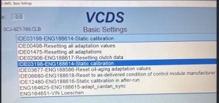

One more time today, Hi Team. :)
Our user need advice about:
29848 - Clutch Actuator for All Wheel Drive
C1292 54 [10101111] - Missing Calibration / Basic Setting

Address 22: AWD (J492)       Labels:| 0CJ-927-749.clb
   Part No SW: 4K0 927 755 D    HW: 0CJ 927 749 A
   Component: C8_DL3_N_SD3H02 0027
   Serial number: 2135128078
   Coding: 010C0000
   Shop #: WSC 12345 123 12345
   ASAM Dataset: EV_AWDCQUOD31 001052
   ROD: EV_AWDCQUOD31.rod
   VCID: 363E5506E8CC90FA25F-8062
                    Mileage: 148028 km
                    Date: 2026.08.06
                    Time: 14:20:43
                    Battery voltage: 11.718 V
                    Engine current: -0.0371 A
                    Internal system status: 00
                    Actuator angle: actual value: 0.484375
                    Vehicle speed: 0.00 km/h
                    Processor load: 73 %
                    Stack store: 00 00 00
                    Engine speed: 0 /min
                    Operating time: 27 min
                    Ambient temperature: 30 °C
                    End stage temperature: 36 °C
                    HW KL15 Debounce Time: 30 ms
                    Combined KL15: 1
                    HW KL15 Filtered: 1
                    HW KL15 Raw: 1
                    SW KL15: 1
                    SW KL15 Timeout: 0
                    System condition: 00 00
                    XCP-DAQ OdtEntryCount: 0
                    UDS Session: OBDII And VW Default Diagnostic Session
                    Standard Seed and Key unlocked: 0
                    Advanced Seed and Key unlocked: 0
                    XCP Calibration activated: 0
                    XCP Measurement active: 0
                    DEV_X_06 enabled: 0
                    Reserved: FF FF FF FF FF FF
                    Unlearning counter according OBD-OBD unlearning counter: 40
                    CC Error Dump (EVENT_CC_CLASSIFICATION_NOT_DONE)-CC Error Dump: 00 00 00 00 00 00 00 00 00 00 00 00 00 00 00 00 00 00 00 00 00 00 00 00

He cannot do this, he is always told that the conditions are not met. I advised him to use a charger, because of the voltage.
@RTSupport, does he need a login, open the hood? Any advice is welcome.

Some comments:
Is ignition ON?
Engine at idle? > Then only ignition
Use [16] 20103 (Maybe check if 20113 is accepted)
Write WSC numbers
Charger as you wrote (13-14 V)
Let it stay with ignition ON for some time.
Ign. OFF, then ON, just before starting BS
There is also BS ENG164625-ENG188615-adapt_cardan_sync that seems to be something with Clutch.

IDE12480-ENG188616-Static calibration in after-run; Is it necessary and what is it for? :o

Is that 4wd clutch changed or what is de reason you want to do this?
Boki Ar
Oct 27, 2014
5,639
5,310
Arandjelovac, Serbia
C?ID=57300
Yes, that's what he says. The clutch was replaced.

You need to find the channel "adaptation of clutch slip points". That's what it says in ODIS.
62,777
43,114
Maybe:
IDE02298-ENG164656 -- Adaptation of clutch kiss points - Calibration mode ?

That setting is with the DSG, right?
In the picture (post #1) you can see everything that is available in this case.
62,777
43,114
Yeah, sorry, I was looking at the data for 02-Auto Trans, not 22-AWD. My bad.

I would go back to IDE12480-ENG188616-Static calibration in after-run; Is it necessary and what is it for?

i would say the 617 first and then the 584 and then do a testdrive like your being in a pursuit.
OK, first IDE02906-ENG188617 – Resetting clutch data, then... What is 584, please.
Typo, maybe?
Edit: OK, IDE03677-ENG188586 - Reset oil-aging adaptation values
Vdub
Dec 18, 2016
971
596
C?ID=57533
Sorry, 586

Sorry Boki, I made a mistake, I was looking for the address ,,02,,. Regarding the address,,,22,, it says, when changing the clutch set, you have to go to the function of replacing the control unit. I have never done this procedure before. I will try to find a comparison car to see where this procedure leads.

1. Preconditions (Critical steps before starting) The most common reason for the "conditions are not met" error is low voltage or a running engine.
Battery charger: Be sure to connect a quality charger. The voltage must be stable and be between 13V and 14V during the entire process.
Ignition / Engine: The key must be in the ignition (Ignition ON), but the engine must be turned off (Engine OFF).
Hood: Open the hood of the vehicle just in case, because some VAG modules block basic settings if the hood is closed.
Security Access: Enter the module 22-AWD -> Security Access [16] and enter the code 20103 (if it is not accepted, try the alternative code 20113).
2. Resetting old adaptations (Mandatory after replacing the clutch) Before the module learns the parameters of the new clutch,
you must delete the wear history of the old part. Go to Adaptations [10] in the 22-AWD module.
Find and execute: IDE02906-ENG188617 – Resetting clutch data.
Find and execute: IDE03677-ENG188586 - Reset oil-aging adaptation values.
3. Basic Settings Procedure when the prerequisites are met and the data reset, it's time for calibration.
It is recommended that you perform a quick cycle before starting: Ignition OFF -> Ignition ON (ignition off, then on again).
Enter Basic Settings [04]. Select the channel: IDE03198-ENG188614 - Static calibration and start the procedure.
Wait for VCDS to display the Finished correctly or Completed status.
After that, start cardan sync via channel: ENG164625-ENG188615 - adapt_cardan_sync.
(Note: Function IDE12480-ENG188616 - Static calibration in after-run
serves for automatic calibration after shutting down the vehicle in regular use, so that the primary focus remains on static calibration while the ignition is ON).
I don't know anything about this for now...
4. Dynamic test (Test drive) After the VCDS has successfully completed the procedure and cleared all errors, the clutch must go through the adaptation process while driving.
Perform a test drive with more dynamic accelerations and turns to allow the system to adjust the contact points under load.
  • Battery charger: Be sure to connect a high-quality stable charger. The voltage must remain steady between 13V and 14V throughout the entire process.
  • Ignition / Engine: The ignition must be ON, but the engine must remain completely OFF.
  • Hood: Open/unlatch the front hood. Many modern VAG modules strictly block basic settings if the hood is closed.
  • Security Access & WSC: Enter module 22-AWD -> Security Access and enter code 20103 (if rejected, try 20113). Note: Ensure your VCDS is configured with valid WSC (Workshop Code), Importer, and Equipment numbers in the settings, as these modules may reject access if generic zeros are used.
  1. Resetting old adaptations (Mandatory after replacing the clutch)
    Before the control module can learn the parameters of the new clutch, you must wipe the wear history of the old part.
  • Go to Adaptations in the 22-AWD module.
  • Find and execute: IDE02906-ENG188617 – Resetting clutch data.
  • Find and execute: IDE03677-ENG188586 - Reset oil-aging adaptation values.
  1. Basic Settings Procedure
    Once the preconditions are met and old data is reset, you can proceed with the calibration.
  • It is highly recommended to perform a quick power cycle right before starting: Ignition OFF -> wait a few seconds -> Ignition ON.
  • Enter Basic Settings.
  • Select the channel: IDE03198-ENG188614 - Static calibration and start the procedure. Wait until VCDS displays "Finished correctly" or "Completed".
  • Next, select and run the cardan synchronization channel: ENG164625-ENG188615 - adapt_cardan_sync.
(Note: The channel IDE12480-ENG188616 - Static calibration in after-run is used by the module for automatic calibrations during regular vehicle operation cycles after key-off, so it can be skipped during this manual repair procedure).
  1. Dynamic Test (Test Drive)
    After VCDS successfully completes the basic settings, clear all remaining fault codes. The AWD clutch must now adapt to real driving loads.
  • Perform a test drive incorporating dynamic accelerations and sharp turns, allowing the system to accurately map the new clutch engagement and touchpoints under load.
