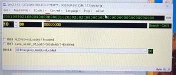

Hello everyone,
I have a 2022 VW Caddy V (MQB Evo).
The vehicle is factory equipped with:
  • ACC
  • Front Assist (Automatic Emergency Braking)
  • Side Assist (Blind Spot Monitoring)
  • Traffic Sign Recognition
  • Front camera (5WA 980 653 C)
I have successfully activated SFD access with VCDS Beta. I am trying to enable Lane Assist. The Lane Assist, Travel Assist and Emergency Assist menus now appear in the infotainment, but all three display: "Function currently unavailable." There are no fault codes in A5 or Steering Assist. I have attached a complete Auto-Scan. Is there anything else I should check, or is this likely related to camera parameterization/dataset or a missing factory activation?
If you need any specific Adaptation, Coding or Measuring Values, I can provide them.
Thank you.

Yes, I found several Lane Assist related options in the A5 Long Coding Helper.
Byte 9 already has:
  • Lane departure warning = Activated
  • Lane Assist system mode = Selection over menu
I also found additional options in Byte 10 (ALDW and Lane Assist off text), but I did not enable them because I was not sure they were correct.
