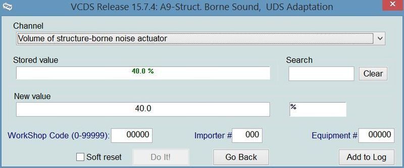

Just installed VCDS 15.7.4.
This relates to MY2015 NAR GTI
Changing SAS is no longer possible without workshop code:
Previously this was possible, evidence:
And my car hasn't been to the dealer since previously reducing the SAS level to 40%, so the different behaviour must be due to VCDS and not onboard module.
Nearly certain that in the past I just clicked No:
Last time I changed the SAS setting was around July 2015. For whatever reason, VCDS Beta 15.6.1 still installed on my "computer" no longer works:(

Use plausible non-zero values for WSC, Importer, and Equipment Number.

Yes, but it worked before without entering those values, as evidenced by the screenshot showing 40%.
Unless I'm remembering wrong and the module forgets those numbers after storage of the new values ?

:confused: Your screenshot shows 15.7.4 ...
