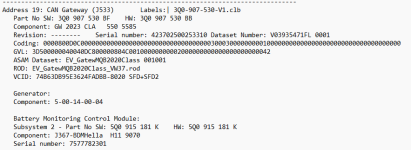

I'm not sure this is an SFD issue, but...
I just got a new 2026 Volkswagen Jetta GLI. I'm coming from two 2009 Mk5s, and have been an authorized VCDS user since that year; but I just upgraded to HEX-VW Enthusiast, and am experimenting as to what I can and can't do with it on the new GLI.
I'm aware generally of the protections that VW has introduced since 2009 -- the hood-open requirement in about 2015, and more-recently SDF and SDF2.
I won't need to replace the battery until three years from now, but I'm trying to see whether VCDS will allow me to register or do an adaptation on the new battery when the time comes.
I've read the Wiki article on battery replacement: https://wiki.ross-tech.com/wiki/index.php/Battery_Replacement
My Battery Monitoring Control Module is a subsystem of the CAN Gateway:
But when I open the 19-CAN Gateway module and press the Adaptation button, I get this error about the diagnostics firewall being on, and that I should open my hood:
Hood is open. Ignition is on; I've tried with engine both on and off.
This error appears whenever I do anything that even looks like I'm trying to modify or adapt something.
I might add that I also have the Carista diagnostics tool; and it seems to allow me to register a new battery without any firewall issues...

Oh, here's a complete Autoscan, if it will help. I've got a question on that too... Why is VCDS unsuccessfully trying to connect to BB-Door Rear Drv and BC-Door Rear Pass, when they're respectively sub-systems of Address 42: Door Elect, Driver and Address 52: Door Elect, Pass.? BB and BC aren't checked on the Installation List:

Address 19: CAN Gateway (J533)       Labels:| 3Q0-907-530-V1.clb
   Part No SW: 3Q0 907 530 BF    HW: 3Q0 907 530 BB
   Component: GW 2023 CLA   550 5585
   Revision: --------    Serial number: 423702500253310 Dataset Number: V03935471FL 0001
   Coding: 0000800D0C00000000000000000000000000000000000300030000000001000000000000000000000000000000000000
   GVL: 3D500000040040DC800000804C00100000000002000000000000000000000042
   ASAM Dataset: EV_GatewMQB2020Class 001001
   ROD: EV_GatewMQB2020Class_VW37.rod
   VCID: 74B63DB95E3624FADBB-8020 SFD+SFD2
   Generator:
   Component: 5-00-14-00-04
   Subsystem 2 - Part No SW: 5Q0 915 181 K    HW: 5Q0 915 181 K
   Component: J367-BDMHella  H11 9070
   Serial number: 7577782301
   Multi-function steering wheel control module:

I would request , from RT Admin., to become a contributor to the SFD (free ,limited time, subscription). If you decide to take part, here is the expectations:
Address 19: CAN Gateway is SFD protected.............
62,777
43,114
I'm confident that with SFD Service, it will.
You're using Release 26.3, which does not yet support on-line SFD.
VW has gotten bit weird with newer cars. Instead of a single, unified Installation List in the Gateway, there are now additional installation lists lurking in other modules. Just ignore BB and BC.
Yes, I saw that info regarding Beta SFD feedback. But I understood it to only be open to "those who purchased unlimited VIN ('Professional') VCDS. Is that incorrect? Mine is merely "Enthusiast"...
So I should participate there, even though I don't intend to go very deeply into SFD/SFD2 bypassing at this time? Specifically, that I won't be registering a new battery for three years?
And yes, I know. Though I don't completely understand yet what-all that means. Does that mean all its subsystems are also SFD- (and in this case also SDF2-) protected?
If that's the case, why is Carista apparently able to transparently access the battery registration function?
I'm not sure yet what VCDS "SFD Service" entails, but I'll find out. That's the same as "on-line SFD support"...?
Yes; 26.3 is the latest version, isn't it? Latest that I could update to, in any case...
So... You're saying that on-line SFD support, once it rolls out completely, should handle battery registration...?
Yes, that's what I intend to do. I'm just not used to seeing red font on my VCDS scans, without panicking... :-)
5,090
3,787
Start with this:
62,777
43,114
There are several "sticky" threads at the top of this forum section that you may wish to read at least the first post or two of. ;)
If you were needing to swap out your battery now, you could do it now with the Beta version, but there are certain requirements to get that. Again, see the "sticky" threads.
   VCID: 74B63DB95E3624FACBA-8020 SFD+SFD2 [x]
   Generator:
