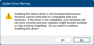

You'll probably get a warning like this:
Click [Yes].
