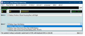

OK - I've had another look at this since yesterday - and now there is a further understanding - It's EZ when U know how!!! - A little clunky but all the information was in place for the battery. The coding for the battery type is done from the "interactive" menu from the coding helper from within battery regulation - I can see this now - I've borrowed Uwe's picture for ease of inclusion as when I was in the car with the laptop taking screenshots is possible but quite difficult.
So, the coding "F326015A" is the correct coding for the WET battery - lead acid - The new battery is the same as the old one. If an AGM battery was installed the coding becomes F326115A - With the fifth digit changing from a zero to a one. Then this would need to be applied with the "DO IT" button pending acceptance from VCDS - But this isn't needed I'm just talking it through.
This would conclude the battery coding - All done - Thank you for your assistance - This seems to have gone very well! - It is now possible to get the car back on the road - Thank you.

OK - I'll take this as a work in progress - with learning steps along the way.
Another query out of interest and in case I've missed something. During some discussions here on the forum the VW OEM part number for the size of battery I've bought and installed is 5K0915105H.
5K0 915 105 H - Does this information need to be input into VCDS? - I thought it would have been but I've not done this and also I've not seen where this would be input if it does need to be. I'd rather ask this rather than not, again for a greater understanding - Thank you.
No, not on this car.
Some older BMS systems required the part number instead of capacity and battery type. They would look up the part number in an internal table and determined the capacity and battery type from the part number.
OK Uwe - Great info - On this car not the case but on some others yes - Glad I asked so no more bases to cover. I was worried that for some "unknown" reason the new battery would just stop working because of not performing some task necessary for correct operation.
