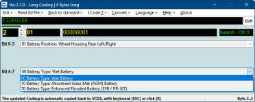

Then there is a current coding field of data present - F326015A - What does F326015A actually mean?
   #40
61,060
41,660
[Select]
[61-Battery Regul.]
[Coding]
[Long Coding Helper]
- look at Byte 2:
