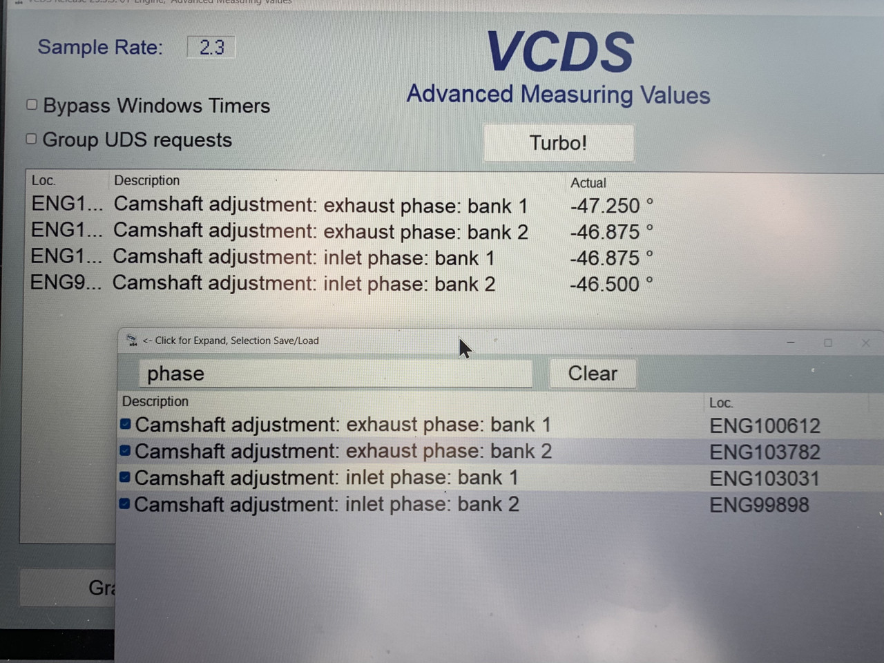

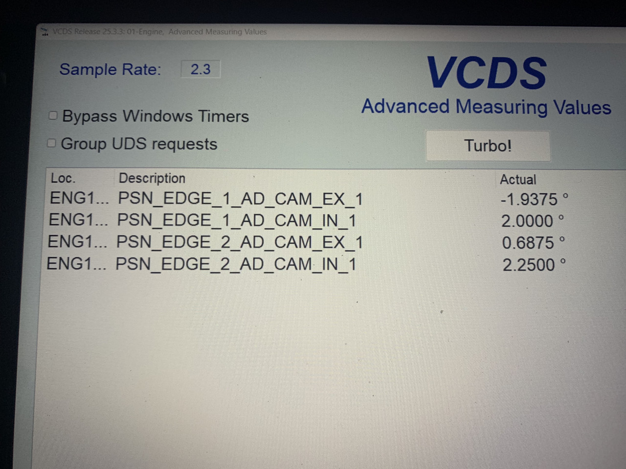

Then I started to get curious about the state of my timing chains lately and while having my computer on the car with my 'new' HEX-NET tool, I might aswell check that too.
I couldn't get there like I saw a few times lately on the net, Eng >> Meas. Blocks. 90, 91, 93, because "Measuring Blocks" wasn't high lighted.
After a short search I found that I had to look at Adv. Meas. Values. After a short while I found the next values.
Is the change in line to follow due to the engine, the software change or something else?
Even more important, how are the values of my chains, they look good to me. Are the 3.2 engines of 2010 any better then before?

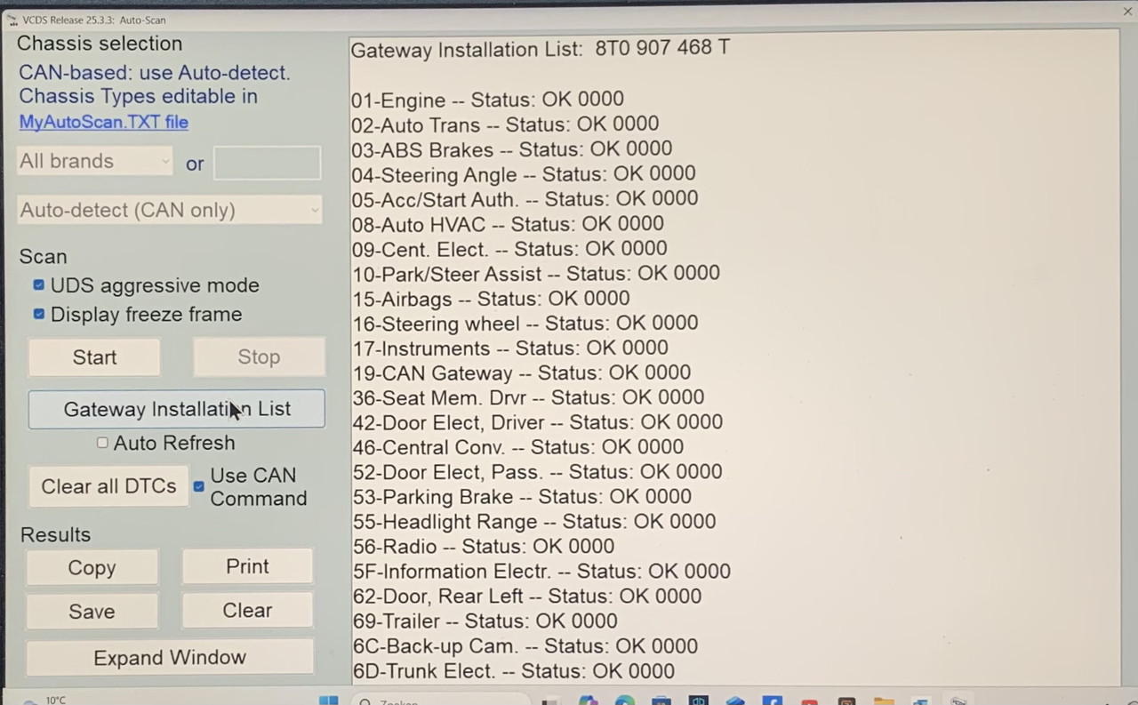

I'll post my LOG aswell

Address 19,8T0 907 468 T,channel 4,adapted from,4F0915105E  JCB 100221L214,to,4F0915105E  VAO 100221L215,
                Address 01: Engine  (8R0 907 559 G)
19:47:51
  ENG101215   PSN_EDGE_1_AD_CAM_EX_1 -1.9375
  ENG102451   PSN_EDGE_1_AD_CAM_IN_1 2.0625
  ENG102237   PSN_EDGE_2_AD_CAM_EX_1 0.6875
  ENG103487   PSN_EDGE_2_AD_CAM_IN_1 2.2500
Address 01: DTCs cleared

Please place the word "phase" in the search field in Adv. Meas. Values , as Uwe recommended, and lets see those just to be sure.
Hot Rod
Nov 16, 2025
22
C?ID=17801
Saturday I’ll have another go and will post the result!
Thanks for the advise. 👍🏼
Hot Rod
Nov 16, 2025
22
C?ID=17801
ll here it is but now I'm completely confused.
Also made a new Log:

Is there anything I can do on the Address 5F: 03276 - Please Check Software Version Management??
Thanks in advance.

I'm scratching my head over those phase readings. They strike me as well into bent valve territory, but I think you'd knowit if that was really the case.
Sure:

Hi Uwe, yeah, when I saw those figures I was really flabbergasted. As if they changed the chains before and didn't installed the timing related parts back together as it should, but the car runs flawless and really has the power it should have.
If for my "software version management" problem, I follow the "Case study procedure", I will have to "reset the MMI". Is that the 3 button press for minimum 2 seconds?
I think so, but I have no personal experience with your particular MMI system.

Well, I don't have much experience with it too :D I just recently found out that I can "upload" MP3 files in it, that then work like a jukebox.
A very nice system because my car is imported from the US, so the radio frequency's are a little difference then in Europe. Therefore the reception is not always good.
So that and on the radiostations the talk way too much and play the wrong music.

About the Cam Phase stuff, is it possible that the whole system is like 45 degrees off? So that the readings should be:
ENG1... Camshaft adjustment: exhaust phase: bank1 -2.250 degree
ENG1... Camshaft adjustment: exhaust phase: bank2 -1.875 degree
ENG1... Camshaft adjustment: inlet phase: bank1 -1.875 degree
ENG9... Camshaft adjustment: inlet phase: bank2 -1.500 degree
This looks a lot more realistic then what I see in VCDS but is it possible that the engine can be rebuild in a way to come to this readings and still function properly?
60,632
41,195
With the engine running well? I don't see how that could be.

I only saw this engine from the outside, changing oil and filters and one time the sparkplugs. It could be possible that if you could mount the gears the other way around, ignition firing and fuel delivery is crankshaft governed, and the cranktiming is only relative to each other??
Something like that?

-46 is about the norm when the vehicle is idling as there is no need for timing advance. I would say its ok.
So are the numbers shifted 45 degrees compared to the 4 in line engines?
What would be the numbers when you want to put on new sprockets and chains?

Hi Uwe,
I followed the instructions and it worked out like a breeze. Everything checks out 'OKE 0000'
Thanks for pointing me in the right direction.
