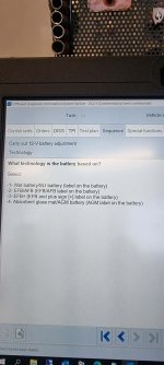

Hey everyone,
Since the temperatures recently dropped (even down to –30 °C), my battery started acting up again, so I wanted to share the story and hear your thoughts.
I bought the car on 4 Nov 2024. It drove perfectly, no obvious issues, and I regularly used the auxiliary heater just like on my previous cars.
One day my wife drove about 200 km to visit relatives, parked the car overnight, used the aux heater in the morning — and the battery was completely flat. Road assistance helped, and on 20 Nov 2024 I replaced the original OE battery with a Moll AFB 76 Ah battery. The battery center recommended the Moll instead of a Varta replacement (previous spec E39, now A7). It was installed, coded, and everything seemed fine.
Fast-forward about a year. When the temperature dropped to –20 °C / –30 °C, the same issue appeared again — flat battery. I charged it fully, drove for a few weeks, and again… flat. That surprised me, because my driving and usage habits haven’t changed: similar engine class, even a stronger alternator than my previous cars, and the same aux-heater usage pattern.
I contacted the battery seller. They checked the battery and said it was undercharged, recommending an “old-school” transformer charger overnight to bring it back to full health. Meanwhile, I visited my old workshop and during a chat they mentioned they’ve seen similar issues with the same Moll AFB batteries, and they actually decided to stop offering AFB as a replacement for AGM, since in practice AFB behaves closer to EFB than AGM.
When I told this again to the battery seller, their response was basically: “You are using the battery incorrectly.”
Looking at Moll’s own documentation:
  • On battery testers, select EFB (or SLI/WET if EFB is not available).
  • AFB is marketed as an AGM replacement.
  • When registering the battery in the vehicle, register it as AGM.
  • For external charging, use EFB/SLI/WET charging mode (AGM mode also works if needed).
So now I’m a bit confused. If the battery should be coded as AGM in the car, but charged externally using EFB settings, it really makes you wonder whether the vehicle’s charging strategy is actually ideal for this battery. Why not code it as EFB in the car as well?
Has anyone else experienced similar behavior with Moll AFB batteries replacing OE AGM units, especially in very cold climates?
