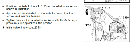

Hi all,
Looking for some guidance on an intermittent cam/crank correlation issue.
Vehicle details:
  • Audi / VW 2.0 TDI
  • Engine code: CAGB
  • Gearbox: 6-speed manual
  • Mileage: ~270,000 km
Fault code:
  • P0016 – Bank 1: CMP (G40) / Crankshaft (G28) – Incorrect Correlation
  • Logged as Intermittent – Confirmed
  • High fault frequency
Symptoms:
  • Car starts and drives normally
  • No rough idle or slow starting
  • No permanent MIL
  • Flashing glow plug (coil) light only under certain load conditions (acceleration / higher load
Relevant history:
  • Timing belt and associated components replaced around 2022/23
  • Since then, car has covered a reasonable mileage with no major drivability issues
  • No consistent boost-related fault codes present
Observations:
  • P0016 is present even when the car feels fine
  • The glow plug light appears to be triggered dynamically under load rather than constantly
Questions:
  1. On CAGB manuals, can a marginal torsion value (still “within spec”) realistically cause:
    • Intermittent P0016
    • Flashing glow plug light under load?
  2. Is checking and fine-adjusting camshaft torsion value the correct next diagnostic step before chasing sensors or wiring?
  3. Any recommended target torsion value for CAGB manuals based on real-world experience?
  4. Anything specific to log in VCDS (measuring blocks / advanced values) to confirm correlation deviation during load?

Any idea how this would happen ? I changed the belt/accessories and used the correct timing kit to line everything up ? Turned the engine over a couple times and everything was good. This was back in 22/23 albeit.
Would putting a new belt kit on be the best option ?#
*Only thing I didn't do was counter hold the camshaft sprocket anticlockwise when tightening up bolts as shown below, however all was aligned ok*

It happens to the best of us, you have to go back in and peg and plate it again. The counter hold anti-clock technique makes a lot of difference. Unless I can turn the engine over by hand, plate the crank, pin the cam pulley and pump without any fiddling, I won’t proceed.
Ill tear down and install new timing kit, ensuring i counter hold the cam sprocket.
Can you explain why the counter hold is important ? Workshop manual doesn't give much detail.
takes the slack out the belt between HPFP & camshaft sprocket so correct tension can be applied.
