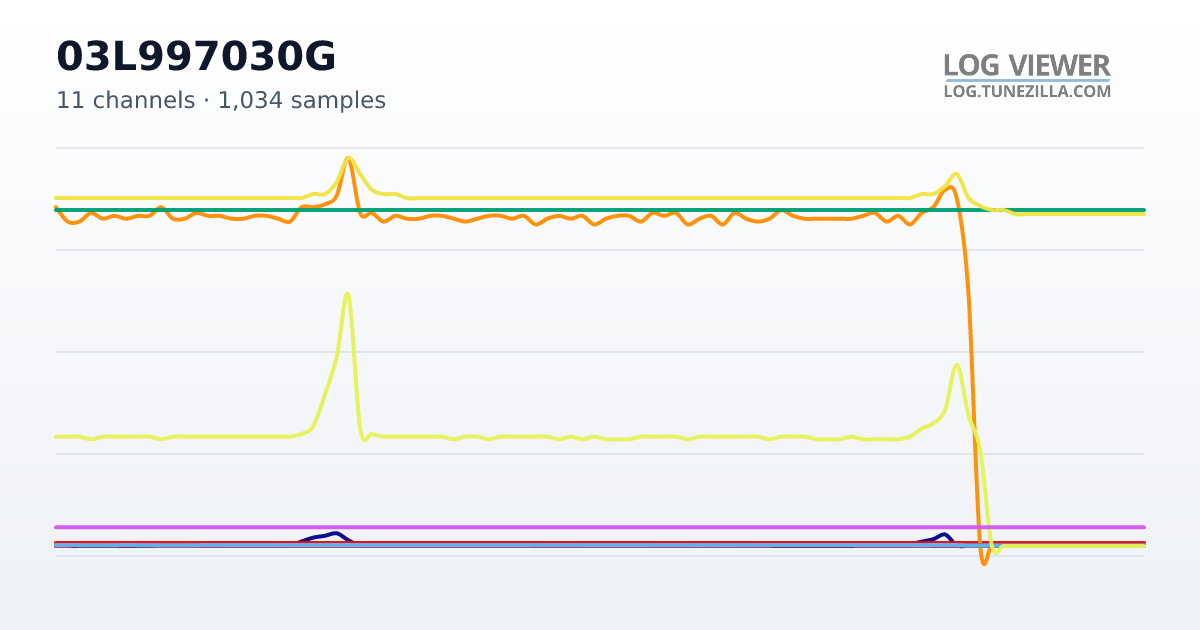

I also did the old map sensor got different results. But I am not getting the P1592 code with the old map sensor plugged in. FYI the Atmospheric pressure currently where I am at is 1025.7
Monday,19,January,2026,17:43:18:20311
VCDS Version: 25.3.2.0 (x64) HEX-V2 CB: 0.4671.5
Data version: 20250822 DS365.0
Address 01: Engine (03L 997 030 G)
17:42:53 Group 010: Charge Pressure Control
0.0 mg/str Mass Air Flow (actual)
1008.0 Atmospheric Pressure
1008.0 Boost Pressure (actual)
0.0 % Accel. Pedal Pos. Sensor 1 (G79)
This I can live with....
The small variation between the barometer reading you're getting from the news or weather app vs the vehicle is acceptable.
Logic says that your atmospheric pressure should match what's in your charge pipes if there's no boost, so we can carry onto the next issue now.
So re-scan, repost current status.
Fix the known leak.
Re-log things.
Re-post.
Throw AI into the garbage, or use it for stupid stuff like making funny pictures, memes, songs, etc.
Rely on logic and your brain instead.

ok, fixed leaks, put stock map sensor back in. here is the latest running log. other codes are gone, just the p0641, and others related to interior of the vehcle, like p1698 which I'm sure is just the steering calibration needing done even tho the steering wheel controls for the gauges and stereo stopped working.
But now there is a new problem that kinda collates with my window issues. hear me out on this. so the windows did work, but then stopped, found corrosion in both window switches, I replaced the switches, they worked for a few minutes then stop, I have to unplug the battery then back in and they will work for a few minutes. Repeat the process to get them to work for a few minutes. Now after getting leaks fixed and reinstalled the original map, the car would not start, never been an issue before just like the windows, I unplugged the battery to drain/reset the system, motor then fired right up no problem. it ran for a few minutes then just shut off, gauges and power were still on but the motor stopped running like i turned it off, then would crank but not fire unless I unplug the battery and reset, then it'll start right up and run for a few minutes. Keep in mind it fires up no problem, idles smooth and revs to its limp rpm smooth and no noticeable motor issues and 2900rpms. boost gauge goes up to 20psi, not sure how accurate that is. Now without the stupid internet, my own deductions are starting to really point at a damaged/ failing ecu, I get to this from process of elimination with my knowledge, Harness new and verified, so not damaged wiring, checked all grounding points I could find with a multimeter, the original harness got damaged while it was running which shut the motor down, this kinda damage could've shorted more than one wire causing a back feed to the ecu possibly damaging it. now with incremental systems failing one by one, I pulled the bcm and visually inspected for burn or water damage on the board, it was clean. These are just my thoughts, and I may very well be wrong, hoping this latest log will help narrow. I am keeping open minded

Included in this log is each Injector. Hopefully it shows something.
Once again, why are you logging what you're logging. What do you think you're capturing, or showing?
You have a DTC for an electrical\wiring issue, but you're showing us injector deviations?
Are you expecting a wiring issue to manifest in a out of whack injector deviation? What's the logic? Asking for a friend!
Are you expecting a wiring issue to manifest in a out of whack injector deviation? What's the logic? Asking for a friend.
Didn't think it would show anything. Just logged them to see what they were doing and if there was a noticeable difference in any of them.

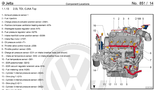

Ok. So i found a damaged wire in the harness buried underneath the vacuum pump, by the coolant temp sensor on the engine. Brown with green stripe, from what i can find that is a a ground sensor wire, tracking with the issue for p0641. You can see it in the pictures. I'm going to remove the engine harness so I can give it a thorough inspection to see if there are anymore. Thank you for sticking with my stubborn dumb ass.

4,302
2,374
There are several sensors and components that share that color wire, so I suggest you unplug the ECM and find out which pin on the harness you get continuity with. This way, you can look at a WD to locate the component linked to it... it could be your crank sensor, cam sensor, intake manifold flap, etc.

C?ID=640767
Ok. Been sick for a bit, finally getting back into this piece of crap! So do I need to disassemble the plug for the ecu to find the pin? I can't find shit for a on diagram for this f'ing thing! I'm getting tired of the lack of info or diagrams, lots of forums but no real flipping help.
