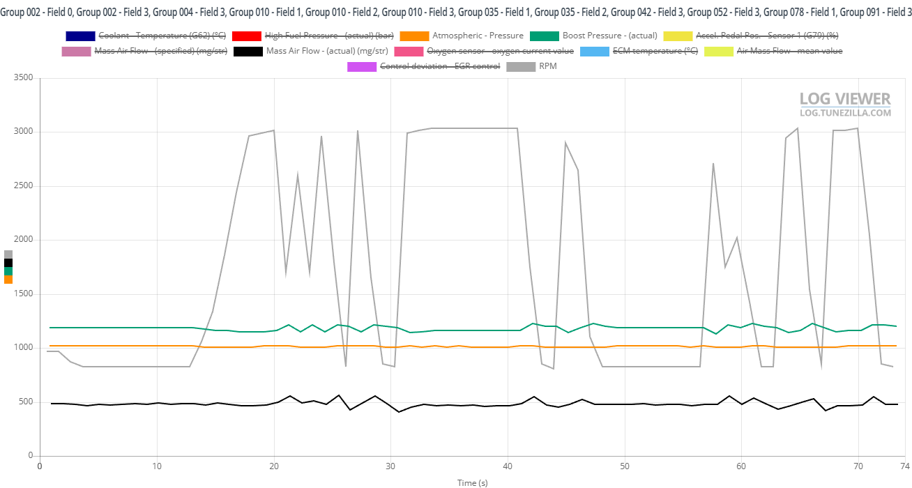

Let's give this another try with hopefully the correct log. Tried cam position and it didn't seem to read any i selected, allot of the selections seemed to not show anything. These were one that were reading, engine speed, high pressure fuel rail, coolant maf, accelerator, o2, map didn't move. Didn't look at the last upload, shit happens.

What problem are you trying to diagnose?
How do any of the things you're logging apply to whatever that problem is?
If you don't know why you're selecting whatever you choose to log, there's no point in showing the rest of us what the results are.
So let be simplify things for you a little, in order to see if you know anything about what you're posting, etc.
Let's look at the initial 20s of your graph
What do you see?
I see you giving it RPM, but I don't see any change in MAF flow and I don't see any boost (does this thing have a turbo or not?).
So, if that's the case, why is that? Is it because you don't have a MAF? Is it because whatever TUNA did causes this heap to no longer read the MAF? If the latter, then what else could it be mapped to read available air off? The MAP? Well, yours is flat AF, so why is that? Do you not have charge pipes connected?
Lastly, if your engine starts and runs (no idea if it runs good, or like crap, since I'm not there and you're not saying), I'd jump to the conclusion that this thing is pig rich at idle, and it fattens up even more as you attempt to drive it and you load it up, causing it to roll some sweet coal (hence the stack), while making it fall flat on its face under any load.

Ok. On my end I see movement with the maf, not much tho, just not sure how much the numbers need to climb or where they are suppose to be, i guess i could've compared them to my maf reading in my mustang to have a better idea. Or looked at the graph, I was looking at the spreadsheet numbers, should've looked at the graph, but I'm posting most of this on my phone and the graph doesn't look right on it, hard to read. The charge pipe is not connected due to a broken oring, waiting on a new oring and didn't want to put it back together to just pull it back apart. That's my bad, I was just wanting to give some readings that might show something, but it didn't show enough with the sensors i could find to select and the lack of assembly. Oring just came in today, also got a new map just incase. I'll be checking readings tomorrow when I get it all back together and see if anything changes. The motor actually runs smooth, but possibly a little rich, idles smooth, revs up to 2900 rpm smooth with no problem, no suit, but obviously not any higher do to limp mode/ p0641. Also I hate the stack, but wife likes it. And I hope it doesn't blow tons of suit, I hate that, it's stupid. But the whole is cut in the hood and I'm not spending the money for a new egr/dpf system or should I say she's not gonna buy it lol.

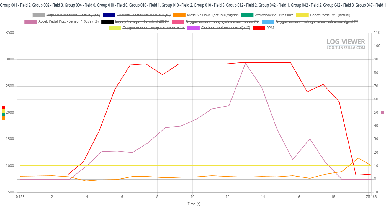

I have come to the conclusion that this car is possessed. I cleaned the maf sensor again. I put the new map in, and new oring. Also keep in mind one of the first things I replaced was the Actuator, it was getting a p00af code, tested the vacuum actuation and it had full movement so I assumed it was the electrical end of it.
Anyway. did another log.
https://log.tunezilla.com/s/5wDpo9eW
You see some movement in the map now and some in the maf, but now getting the p00af code again for the actuator, and now a new code,
Altitude Sensor / Boost Pressure Sensor P1592 - 000 - Implausible Correlation. Never seen that one as of yet.
Still has p0641 and still in limp mode. Been checking for boost and vacuum leaks, unfortunately I do not have a smoke machine at home to help in this process. Also tracing wires to find shorts or brakes, have not found any at this point. Since it starts, idles smooth, and revs to limp rpm with no issues which it actually went up another 100 rpm from previous, I am not thinking there is an issue with the cam position sensor.

ok, found vacuum leak, brake booster line is cracked, once i fix that hopefully p1592 a p00af will go away. back to the stupid p0641 code, after i replace the brake booster line and check to see if it gets more boost since the leak was causing problems with the n75 intern problems with the actuator.

Where did the MAP sensor come from? Is it OEM or some Amazon garbage?
It's clearly not a good one since it's never reading anywhere near the atmospheric pressure.

Got it from the vw dealership here in town. Our atmospheric pressure here is actually about what the map sensor is reading at idle, and reading around the same as the previous sensor. But do to the lack of boost, from my research this will cause a bad reading while revving the motor, at idle it's reading almost prefect atmospheric. But when bringing the rpms up and the little to no boost not building as it should will cause the atmospheric to lower, atleast from what I've read and understand. So now that I found the vacuum leak causing the n75 to pop a code and the actuator to pop a code again, making it to where it will not create correct boost from my understanding. Once the brake booster line is replaced hopefully it'll start creating boost and get better readings.
So up to ~13s mark, the green and orange lines are overlapping.... GOT IT..... thank God I have an optometrist appointment tomorrow afternoon.... I clearly need new glasses!

I am not understanding your sarcasm. I don't see any overlapping. My location is 1025 bar, i am only 30 meters above see level. Did this log before finding vacuum leak. The vacuum leak to the n75 and limp mode both can cause no boost or lower boost, which will cause the atmospheric to read wrong/ low as well. Am I incorrect with this? All I know is that both boost and atmospheric are both lower then they should be when increasing the rpms, which the lack of boost is from the vacuum leak, since i have not found a boost leak as of yet. is this incorrect?
