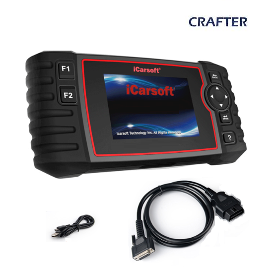

or at least can someone let me know of a diagnostic scanner that can actually provide me with the readings I need to determine if I actually have a sensor problem or if can just be re-calibrated?

As RGH0 said though, if you've already binned 4 other tools due to this vehicle, maybe a little more research before you buy would serve you better. You'd have had the same answers if you'd asked the same question in the Pre-Sales Support section, had you asked... you know... pre-sale?
