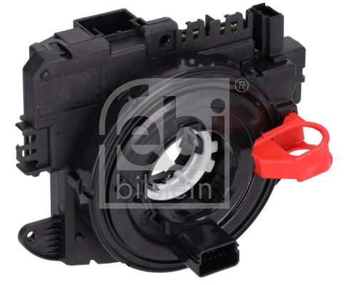

Clockspring replacement (2012 Passat)

Hi, i have changed clock spring on this passat b7 because car has accident. I posted Auto scan before and after replacement. Tried to put original coding in 16 steering wheel but it says coding out of range. Why? Can someone help me? I cant start car now because diesel tank is not on the car, now repairshop is working on the damage. Thanks in forward.
4,251
3,121
note the SW and HW numbers:
2012 B7 Passat:
(original coding, scan 1)
Address 16: Steering wheel (J527) Labels:| 5K0-953-569.clb
Part No SW: 5K0 953 569 AS HW: 5K0 953 569 AS
Component: LENKS.MODUL 016 0180
Revision: --X01--- Serial number: 20190813200238 Coding: 399AA50000
(replacement coding, scan 2)
Address 16: Steering wheel (J527) Labels:| 3C0-953-569.clb
Part No SW:
3C9 953 501 BN HW: 5K0 953 569 AB
Component: LENKS.MODUL 009 0135
Revision: FF010036 Serial number: 20100527300754
Coding: 1182270002
I suspect your replacement part is a earlier version than the original ( AS vs. AB)
Also, note the software (sw) number.
Try to find a replacement with the same part number (HW) xxx xxx xxx AS and
SW: xxx xxx xxx AS.
Then VCDS can change the coding if necessary. Other members may chime in with what replacements may also work if you can not find a part with the same SW and HW numbers.

Clock spring that has been on the car was manufactured from 2019 probabbly changed. I put this replacement from 2010 i think it’s older like you said but multifunction on the steering wheel works, horn and all that stuff that i can try it with ignition on.
2012 B7 Passat:
Part No SW:
Coding: 1182270002
SW: xxx xxx xxx AS.
Jakov
Jul 6, 2024
11
3
Kruševac, Serbia
C?ID=582592
Thanks for your answer, i will wait till shop finishes body work maybe someone can help me, if not i will try to find with this exact number.
3,469
2,968
5K0 953 569 AB changed to 5K0 953 569 T and then 5K0 953 569 AS so the one fitted is too early.
3,469
2,968
5K0 953 569 AS is readily available aftermarket avoiding gambling and losing time and money using second hand parts. I would fit the FEBI 199079
Ziddywerks
Jun 28, 2014
5,849
4,020
Northern NJ USA
C?ID=208579
I would not recommend fitting that garbage.
  • Agree
Reactions: Jef
golfi_vend
Apr 9, 2014
2,498
2,424
Tartu, Estonia
C?ID=195131
Febi is good replacement to OE, yes not OE, but better than TOPRAN.
Although i looked and no supplier gives Febi Available.
PS! Most likely FEBI here is supplier and inside box is OE part as it is with other clocksprings at the market.
3,469
2,968
I cannot disagree more strongly, I have been using FEBI for four decades nd I have had near zero problems. Bosch and Hella don't offer this part, Febi, Borsehung and Vemo are the main sources.
Ziddywerks
Jun 28, 2014
5,849
4,020
Northern NJ USA
C?ID=208579
I cannot disagree more strongly, I have been using FEBI for four decades nd I have had neat zero problems. Bosch and Hella don't offer this part, Febi, Borsehung and Vemo are the main sources.
Ill put in a factory part before I dare to use Febi anything.

I cant find used original clock spring with these letters, its almost impossible i tried with replacing only control coil cable and now horn, dsg paddle shift and steering multifunctions works on original clock spring but still have yellow lamp and esp, TPMS light. Does anyone in a neighborhood have clock spring with these letters to sell?

Can't blame. The price for this Passat clockspring is ridicolous and has gone up a crazy ammount over the last years. I also think that they had to restart manufactoring at some point because there was a time where I had 7 OE clockspring in backorder for months.
Also used parts cost redcilous. Salvage yards know the cost for this.
As for fault it seems that You have misplaced the mechanical part in clockspring as there is internal angle sensor and if You miss that, game over. -> You could try checing MVB to see the internal angle and then opening it back up.
Also two: Saying can't find used has to mean can't actually find it, not it costs too much for used/new part that I'm not willing to buy it:
3,469
2,968
The VEMO V10-72-0201 is readily available.

Ordered original new part, don’t wanna waste more time. Thanks all for trying to help.
