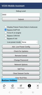

my mobile app wont load past the initial screen. select dongle and next screen does nothing. everything is up to date and dongle works otherwise.
   #27
Shaun
1,999
3,271
How does your HEX-NET connect to wifi, AP mode or infrastructure? In either case, test switching it to see if the other mode works.

BTW the "done, go back button is sometime hidden after the scan-refresh etc. command bar (on my Samsung Xcover7).
Regards,
Paul
