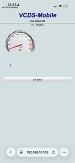

Not looking promising for vcds-mobile. Did the updates as per above, dowloaded asam when asked, that part work good.
However, live data HUD is still not showing valid data. Selected coolant temperature and shows 0 with engine warm.
Trying to select another pid ends with loading asam stuck at 0% for a good while, when I decided to boil-off inside home and not in the car.
I wish so hard to see at least:
Coolant temp
Battery voltage (terminal 30)
Long term fuel trim
Short term fuel trim

If you do more testing, please try in mobile: [Options] -> [Clear Dataset Cache], then go to [Advanced Measuring Values] for this controller and let it rebuild the list.

Did as per above, asam loaded, however, coolant temp remains zero. Trying to select some other pid removes the 2x3 block completely, app freezes, no joy.

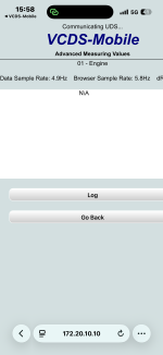

So today i got some time and i checked vcds with laptop via cable and with wifi both ap and infrastrucure mode working perfectly i can view live data fault codes etc etc so its working good, but with the mobile app doesnt matter if its in ap or if mode live data wont show anything, tried to clear rod files and data and them download again its just says n/a
I can pick anything from the live data colunn but n/a does not matter if its engine or auto trans or brake abs module.
Tried with safari and google chrome with an iphone 16 pro max
Maybe any chance to make it work with my phone?

Yes submit and then that screen appeara that i uploaded and nothing happens waited for few min but nothing

Thanks for yout reply, i cant upload that pic its too large but lets say i choose 01 engine and live data all live data will load so i can pick anything engine rpm, coolant temp, etc etc but when i tick lets say engine rpm and than submit a new window will appear and it says n/a not even says engine rpm
