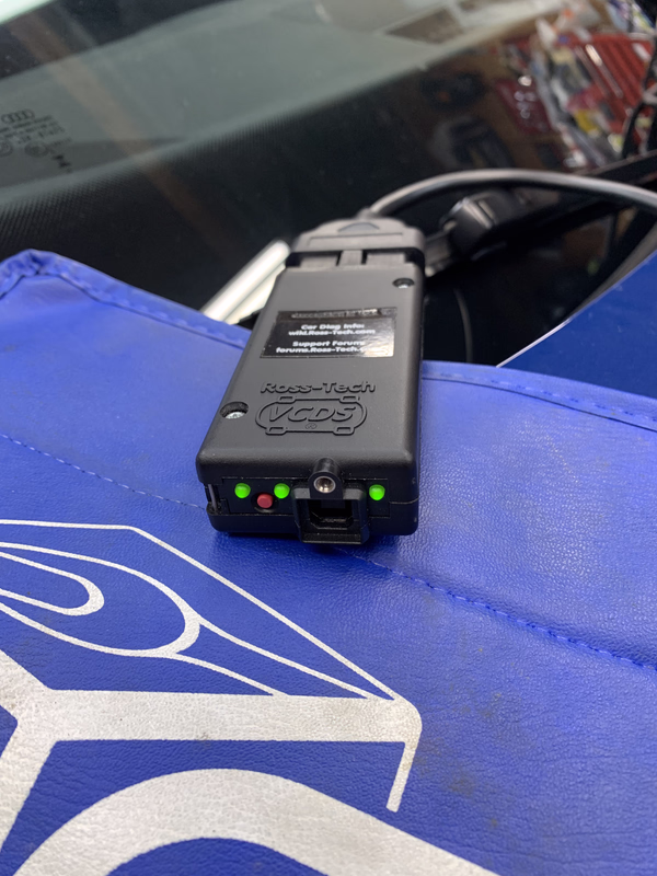

EDIT: Ok, I plugged into usb, held red button (only took about 15 sec.) dbl. beep , let go of button, long beep. first led red/amber flashing , middle led green.
I did this three times as I was expecting a longer reset time.
Went into vconfig and cleared out all of my IP addresses (8 or 9 of them , all the same , "forget this network" delete.
clicked on wifi and my IP address, entered PW , it connected ; router configured (I think).
Unplugged from USB and went out to vehicle and plugged HN in. Waited about 20 seconds or more (it wasn't looking good, first led blinking green, but second led flashing red , third solid green) . Then middle led went green! But then it connected! Hallelujah! Its not a V2 anymore!

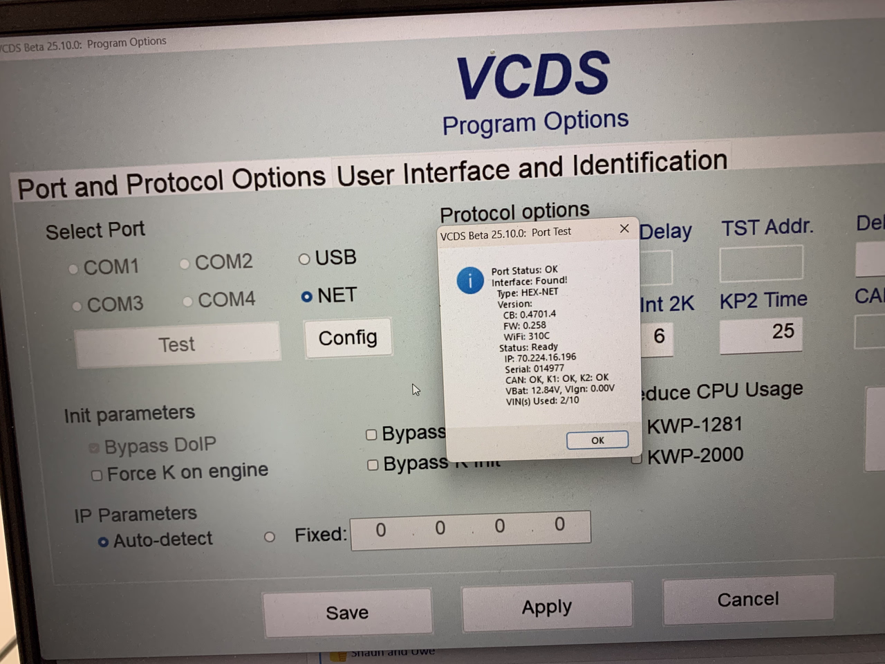

Far be it from me to argue with success, but I think it's the first time I've seen someone's public IP in VCDS' Options->Test :D

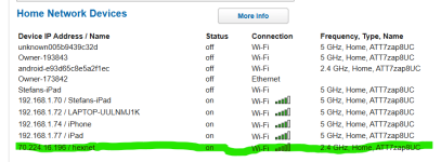

Yeah, uhm... Why do I think AT&T reconfigured his router as a bridge?
   #28
4,892
3,641
I noticed that IP address also. It IS different than the one I had , it used to end in dot 65.
