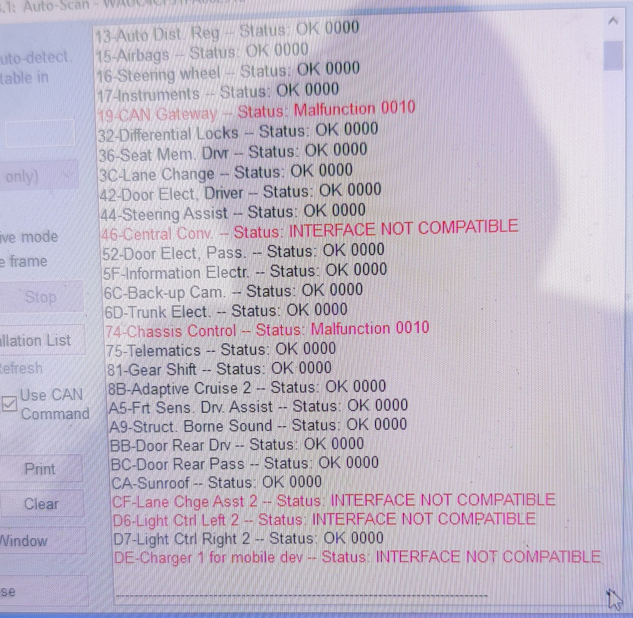

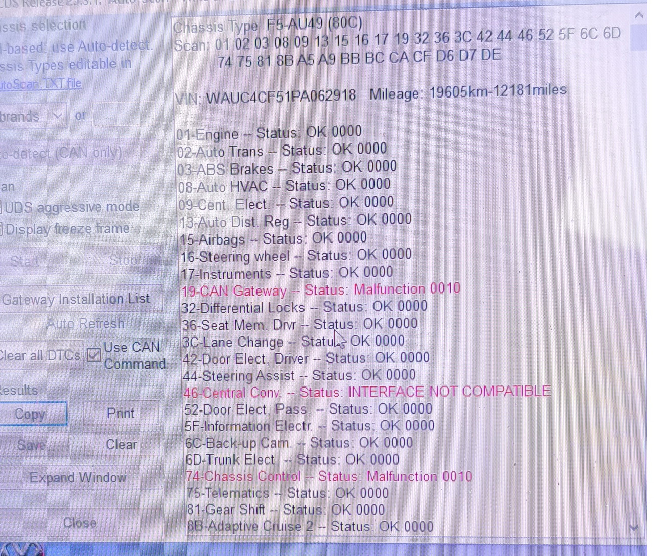

Here is autoscan:

Seems you cropped off the Header (top of the page) with date, data, and VIN. Please post that header information.
