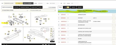

10,917
Western PA, USA
It might be best to get the wiring diagrams and component locators straight from Lambo directly but after I clicked here:
... I got redirected to NAR Audi's site followed by: https://serviceinformation.lamborghini.com/
Slightly convoluted so please let us know if you have success so we can update our Wiki links.
In the meanwhile I searched "DGFA" scans and those Huracan results ranged between 2018 and 2020. All appear to have Address 6C: Back-up Cam. (J772) type: Part No SW: 4S0 980 556 A
Here's a random one:
In addition, the same unit is found the R8 and here's one for example:
PL24 does not cover Lamborghini so we do not have access to PR-Codes, part numbers, etc but you can try searching for that part number using your sources.

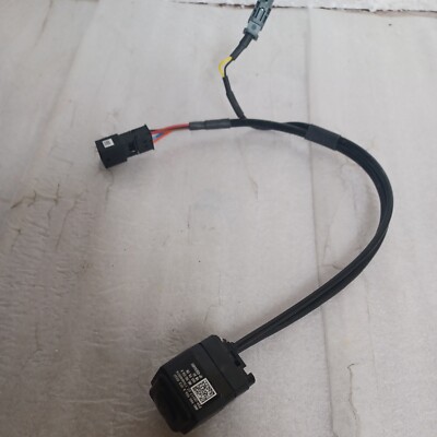

10,917
Western PA, USA
I'm not sure why I didn't do this yesterday but I google searched that part number. Tiny little thing per the photo and part number in this random eBay listing:
At a glance I would have ASSumed that was just a camera rather than a control module and camera unit in one! In conclusion I think that R8 component locator in post #9 is entirely accurate.

Florida, USA
C?ID=158578
I am leaning towrads that aw well due to the dealership showing no seperate module exists and the location where it should be is empty with no cut wiring etc or empty plugs. I ordered a new camera and will cross my fingers that is the issue.
I do have switched 12v at the plug but there is only 3 wires vs the 4 shown on the audi diagram.
I will have it at the end of the week and will report back.

C?ID=158578
Verify power and ground at camera.
I have switched 12v on pin one but the other pins I am not sure if that is data lines as there is no pin in the ground location on the audi diagram. I ordered a new camera hoping that is the issue.
