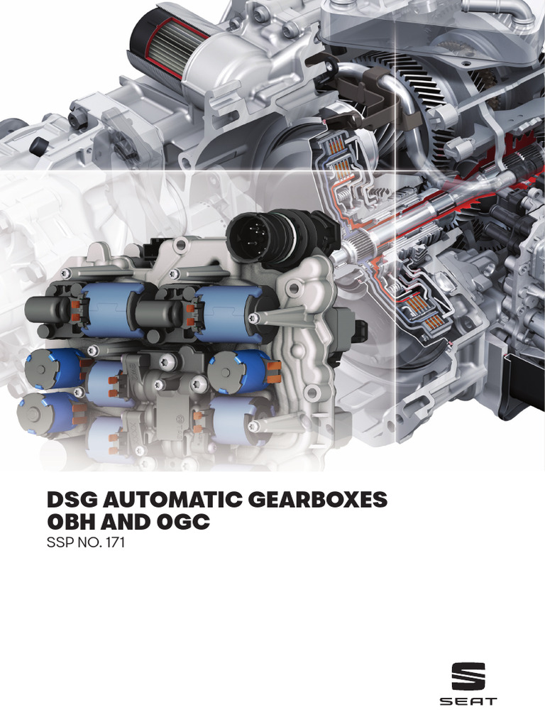

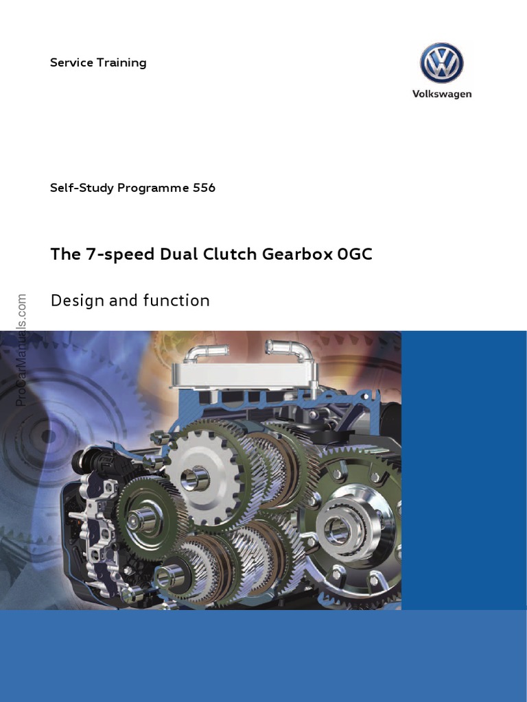

DQ500 won't go into gear, no codes (2008 VW R32)
Bizmarkie
Oct 26, 2025
4
TX, USA
C?ID=578464
Hi experts,
I have a 2008 VW R32 with a turbo upgrade and it's mated to a DQ500 to handle the power. The gearbox is very young but the problem started with the car refusing to go into R or D. It would grab eventually, hard, and then work fine until you park it again and it gets cold. It has progressed to where nothing I can do will make it grab a gear. In the process, I got the PRNDS flashing warning and codes for Clutch 1 and 2 unintentionally releasing.
We replaced the mechtronic recently and it did not help the performance, although the codes went away. There are no codes on the TCU, and the only codes on the ECU are for changing the battery (steering angle sensor, etc).
We tried to apply basic settings and it fails for "Aborted Safety Reasons" and nothing I can do will make it work. Nothing I can do makes any sound come out of the gearbox either. It seems like it's either not getting instructions or its incapable of any internal movement.
When I put the car into any gear, none of the adv measurement pressure settings change.
Any suggestions on what to diagnose next would be greatly appreciated!
Thanks!
PS - I've verified the gear selector setting is correct in VCDS so that's working fine
Thursday,03,July,2025,14:20:13:51193
VCDS Version: 25.3.1.2 (x64)  HEX-V2 CB: 0.4671.4
Data version: 20250604 DS365.0
VIN: WVWKC71K48W053558   License Plate:
Mileage: 134670km-83680mi   Repair Order:
Chassis Type: 1K-VW35 (7N0)
Scan: 01 02 03 08 09 0F 15 16 17 19 22 25 42 44 46 47 52 55 56 65
VIN: WVWKC71K48W053558   Mileage: 134670km-83680miles
02-Auto Trans -- Status: Malfunction 0010
0F-Digital Radio -- Status: Malfunction 0010
22-AWD -- Status: OK 0000
56-Radio -- Status: OK 0000
65-Tire Pressure -- Status: OK 0000
Address 01: Engine        Labels: None
   Part No SW: HPA Turbo FT    HW: 022 906 032 GP
   Component: X600-750A      *G   1601
   Revision: --H02---    Serial number: VWX7Z0G53NQ8SM
   Coding: 0000178
   Shop #: WSC 01279 785 00200
   VCID: 7F5B1478DBF10362F63-802A
   VINID: 9E69DB4C705B1089C01431452033C1DF46
4 Faults Found:
000113 - Sensor for Ambient Air Temperature (G17)
               P0071 - 004 - Implausible Signal - Intermittent
000104 - MAP/MAF <-> Throttle Position Correlation
               P0068 - 002 -  - Intermittent
000257 - Mass Air Flow Sensor (G70)
               P0101 - 008 - Implausible Signal
005668 - MIL Request Signal Active (Check TCM for errors too!)
               P1624 - 008 -
Readiness: 0010 0000
Address 02: Auto Trans (J743)       Labels:. 0BH-927-711.clb
   Part No SW: 0BH 300 012 D    HW: 0BH 927 711 G
   Component: DSG DQ500-7A  H11 2224
   Revision: 00H11V01    CVN: FC3EF8F1
   Coding: 0014
   ASAM Dataset: EV_TCMDQ500021 001001
   ROD: EV_TCMDQ500021.rod
   VCID: 2411FB141E5780BACB1-8070
5 Faults Found:
10657 - RPM Signal from ECU
          P0726 00 [00101111] - Implausible Signal
                    Fault Priority: 0
                    Fault Frequency: 5
                    Mileage: 134657 km
                    Date: 2000.00.00
                    Time: 09:55:24
                    Engine speed: 0.00 /min
                    Vehicle speed: 255 km/h
                    Coolant temperature: 215  C
                    selected gear: GANG_UNDEFINIERT
                    Engine torque: 4 Nm
                    Control Module temperature: 93  C
                    Accelerator pedal position: 0.0 %
                    DTC memory status: 255
10693 - Clutch 1 Opens Unintentionally
          P175D 00 [10101100] - -
          MIL ON - Intermittent - Confirmed - Tested Since Memory Clear
                    Fault Priority: 0
                    Fault Frequency: 6
                    Mileage: 134657 km
                    Date: 2000.00.00
                    Time: 11:53:57
                    Engine speed: 1166.00 /min
                    Vehicle speed: 255 km/h
                    Coolant temperature: 215  C
                    selected gear: GANG_UNDEFINIERT
                    Engine torque: 24 Nm
                    Control Module temperature: 61  C
                    Accelerator pedal position: 0.0 %
                    DTC memory status: 255
10694 - Clutch 2 Opens Unintentionally
          P176E 00 [10101110] - -
          MIL ON - Intermittent - Confirmed - Tested Since Memory Clear
                    Fault Priority: 0
                    Fault Frequency: 5
                    Mileage: 134657 km
                    Date: 2000.00.00
                    Time: 11:54:09
                    Engine speed: 1151.00 /min
                    Vehicle speed: 255 km/h
                    Coolant temperature: 215  C
                    selected gear: GANG_UNDEFINIERT
                    Engine torque: 8 Nm
                    Control Module temperature: 61  C
                    Accelerator pedal position: 0.0 %
                    DTC memory status: 255
10928 - Main Pressure Adaptation
          P184A 00 [00101100] - Offset Upper Limit Exceeded
                    Fault Priority: 0
                    Mileage: 134667 km
                    Date: 2000.00.00
                    Time: 12:07:25
                    Engine speed: 1745.00 /min
                    Vehicle speed: 255 km/h
                    Coolant temperature: 215  C
                    selected gear: GANG_UNDEFINIERT
                    Engine torque: 40 Nm
                    Control Module temperature: 84  C
                    Accelerator pedal position: 0.0 %
                    DTC memory status: 255
23182 - Clutch Positioning
          P0810 00 [10101100] - Control Error
          MIL ON - Intermittent - Confirmed - Tested Since Memory Clear
                    Fault Priority: 0
                    Fault Frequency: 2
                    Mileage: 134657 km
                    Date: 2000.00.00
                    Time: 11:54:32
                    Engine speed: 1325.00 /min
                    Vehicle speed: 255 km/h
                    Coolant temperature: 215  C
                    selected gear: GANG_UNDEFINIERT
                    Engine torque: 20 Nm
                    Control Module temperature: 63  C
                    Accelerator pedal position: 0.0 %
                    DTC memory status: 255
Address 03: ABS Brakes        Labels: 1K0-907-379-MK60-A.clb
   Part No SW: 1K0 907 379 AB    HW: 1K0 907 379 AB
   Component: ESP 4MOTION MK60    0102
   Revision: 00H13001
   Coding: 0021128
   Shop #: WSC 01279 785 00200
   VCID: 72BDCD4C98A35E0A89D-8026
01314 - Engine Control Module
            013 - Check DTC Memory
Address 08: Auto HVAC        Labels: 1K0-907-044.lbl
   Part No SW: 1K0 907 044 BS    HW: 1K0 907 044 BS
   Component: ClimatronicPQ35 120 1111
   Revision: 00120021    Serial number: 00000000000000
   VCID: 79AFFA60C5D52D52C87-802C
Address 09: Cent. Elect.        Labels:. 3C0-937-049-30-H.lbl
   Part No SW: 3C0 937 049 AJ    HW: 3C0 937 049 AJ
   Component: Bordnetz-SG     H54 2202
   Revision: 00H54000    Serial number: 01000007318666
   Coding: 978D8F2140041500C7140000001400008009720B64000100000000000000
   Shop #: WSC 24315 444 58717
   VCID: 71BFC2409DA56512707-8024
   Subsystem 1 - Part No: 1K1 955 119 E  Labels: 1KX-955-119.CLB
   Component: Wischer 040707 021  0501
   Coding: 00040853
   Shop #: WSC 24315
Address 0F: Digital Radio        Labels: 8E0-035-593-SIR.lbl
   Part No SW: 8E0 035 593 H    HW: 8E0 035 593 H
   Component: SDAR SIRIUS     H06 0080
   Revision: 00000000    Serial number: AUZ4Z7G0100434
   VCID: 2E05193C4C1B3AEA2D5-807A
02635 - Tuner Not Enabled/Activated
            000 - -
                    Fault Status: 01100000
                    Fault Priority: 7
                    Reset counter: 17
                    Mileage: 134571 km
                    Date: 2000.00.00
                    Time: 15:51:27
02788 - Internal Communications Error
            000 - -
                    Fault Status: 01100000
                    Fault Priority: 7
                    Fault Frequency: 6
                    Reset counter: 18
                    Mileage: 134675 km
                    Date: 2000.00.00
                    Time: 14:13:17
                    Bin. Bits: 00000000
                    Bin. Bits: 00000001
Address 15: Airbags        Labels: 1K0-909-605.lbl
   Part No SW: 1K0 909 605 AB    HW: 1K0 909 605 AB
   Component: 6T AIRBAG VW8R  034 8000
   Revision: 05034000    Serial number: 003B6D091K1L
   Coding: 0013908
   Shop #: WSC 01269 785 00200
   VCID: 6C81D334BA8788FA431-8038
   Subsystem 1 - Part No: 1K0 959 339 G
   Component: BF-Gewichtsens. 007 0007
   Subsystem 2 - Serial number: 6332MSME1A00142B0
   Subsystem 3 - Serial number: 6342MSME19486674H
   Subsystem 4 - Serial number: 6352QSME2D2C2137J
   Subsystem 5 - Serial number: 6362QSME334B783FW
   Subsystem 6 - Serial number: 63727SME0D47212C1
   Subsystem 7 - Serial number: 63827SME0D4769099
Address 16: Steering wheel        Labels: 1K0-953-549-MY8.lbl
   Part No SW: 1K0 953 549 AQ    HW: 1K0 953 549 AQ
   Component: J0527           036 0070
   Coding: 0012122
   Shop #: WSC 01279 785 00200
   VCID: 015F9280AD057592807-8054
   Subsystem 1 - Part No: XXXXXXXXXXX
   Component: E0221           002 0010
Address 17: Instruments        Labels: 1K0-920-xxx-17.lbl
   Part No SW: 1K6 920 974 D    HW: 1K6 920 974 D
   Component: KOMBIINSTRUMENT VDD 1216
   Revision: V0002000    Serial number: VWX7Z0G53NQ8SM
   Coding: 0007203
   Shop #: WSC 24315 444 52549
   VCID: 35373650A94D09326CF-8060
Address 19: CAN Gateway (J533)       Labels:. 7N0-907-530-V2.clb
   Part No SW: 7N0 907 530 AK    HW: 7N0 907 530 AK
   Component: J533  Gateway H57 1642
   Revision:   H57       Serial number: 060124F1000231
   Coding: 350000
   Shop #: WSC 12345 123 12345
   VCID: 79AFFA60C9D52D52C87-802C
Address 22: AWD        Labels: 1K0-907-554.lbl
   Part No: 1K0 907 554 L
   Component: Haldex 4Motion      0116
   Coding: 0000001
   VCID: 3635315CB44B022A655-8062
Address 25: Immobilizer        Labels: 1K0-920-xxx-25.clb
   Part No SW: 1K6 920 974 D    HW: 1K6 920 974 D
   Component: IMMO            VDD 1216
   Revision: V0002000    Serial number: VWX7Z0G53NQ8SM
   VCID: 35373650A94D09326CF-8060
Address 42: Door Elect, Driver        Labels:. 1K0-959-701-MIN3.clb
   Part No SW: 1K0 959 701 M    HW: 1K0 959 701 M
   Component: Tuer-SG         006 120A
   Coding: 0001077
   Shop #: WSC 01279 785 00200
   VCID: 38293F64BE5FF45A779-806C
Address 44: Steering Assist        Labels: 1Kx-909-144-G2V3.clb
   Part No: 1K1 909 144 M
   Component: EPS_ZFLS Kl.141 H08 1901
   Shop #: WSC 00000 028 00001
   VCID: 35373650A94D09326CF-8060
Address 46: Central Conv.        Labels:. 1K0-959-433-MAX.clb
   Part No SW: 1K0 959 433 CT    HW: 1K0 959 433 CT
   Component:    KSG PQ35 RDK 052 0221
   Revision: 00052000    Serial number: 00000000000000
   Coding: 139006885103281B0904058FB0080A04889C00
   Shop #: WSC 01287 785 00200
   VCID: 04519B94B21760BAAB1-8050
   Subsystem 1 - Component:   Sounder n.mounted
   Subsystem 2 - Component:       NGS n.mounted
   Subsystem 3 - Component:      IRUE n.mounted
Address 47: Sound System        Labels: 3C0-035-456.clb
   Part No: 1K6 035 456 A
   Component: 08K Audioverst.     0005
   Revision: 00003000    Serial number: 00000000143986
   VCID: 2A0D152C70F356CAF1D-807E
Address 52: Door Elect, Pass.        Labels:. 1K0-959-702-MIN3.clb
   Part No SW: 1K0 959 702 M    HW: 1K0 959 702 M
   Component: Tuer-SG         006 120A
   Coding: 0001076
   Shop #: WSC 01279 785 00200
   VCID: 392F3A608555ED52887-806C
Address 55: Headlight Range        Labels: 1T0-907-357.lbl
   Part No: 1T0 907 357
   Component: Dynamische LWR      0003
   Coding: 0000004
   Shop #: WSC 01279 785 00200
   VCID: 74B1CB54E2B7503A9B1-8020
Address 56: Radio        Labels: 1K0-035-1xx-56.clb
   Part No SW: 1K0 035 180 L    HW: 1K0 035 180 L
   Component: Radio PM6       018 0035
   Revision: 00018000    Serial number: VWZ5Z7G2160222
   Coding: 0010011
   Shop #: WSC 01279 785 00200
   VCID: 290FEA2075F55DD2F87-807C
Address 65: Tire Pressure        Labels: 3C0-959-433-65.lbl
   Part No SW: 1K0 959 433 CT    HW: 1K0 959 433 CT
   Component:    RDK              0450
   Revision: 00052000    Serial number: 00000000000000
   Coding: 0100101
   VCID: 04519B94B21760BAAB1-8050
End----------(Elapsed Time: 01:18, VBatt start/end: 13.3V/13.2V)-----------
------------------------------12 Faults Found------------------------------
Bizmarkie
Oct 26, 2025
4
TX, USA
C?ID=578464
I believe so. I drove it about 200 miles and once it would get going it shifted flawlessly and had great power.
The company that did the work also tested it extensively including dyno and road work.
Bizmarkie
Oct 26, 2025
4
TX, USA
C?ID=578464
Can anyone explain in simple terms how the pressure is created and controlled to operate the clutches inside a DQ500? I understand there are 2 pumps? a general supply and a hydraulic one inside the mechatronic, is that right? And there are two pressure sensors that are known to go bad, K1 and K2?
Are those readings the oil pressure in the mechatronic or the pressure the solenoid is pressing on the clutch with?
Thanks in advance!
iichel
Aug 10, 2016
4,753
5,163
Netherlands, Operation Market Garden
C?ID=284912
jyoung8607
FoRT
Feb 25, 2014
2,883
4,666
Garrettsville, OH
C?ID=25607
I don't like your freeze-frames having bogus values for vehicle speed (255 km/h) and accelerator pedal position (0% even with off-idle engine RPM and torque) as well as sometimes not seeing RPM.
Your DQ500 has live measuring values for that data, see here for maps of a DQ500 in a RSQ3: https://forums.ross-tech.com/index.php?threads/26685/#post-228249
I would look at those and make sure it's consistently receiving engine RPM, accelerator position, and vehicle speed over CAN. If it's not, then that's an indicator you have software interop issues somewhere in your ECU / mechatronic / ABS combination. In that case, drivability issues are definitely expected, and you're not meeting those safety preconditions for running basic settings.
Bizmarkie
Oct 26, 2025
4
TX, USA
C?ID=578464
Thank you jyoung and iichel!
To mate the VR6 to the DQ500 I think there are some software gymnastics required. I know we need a specific vintage mechtronic for the application.
Ill start digging there.
I appreciate you both so much!
