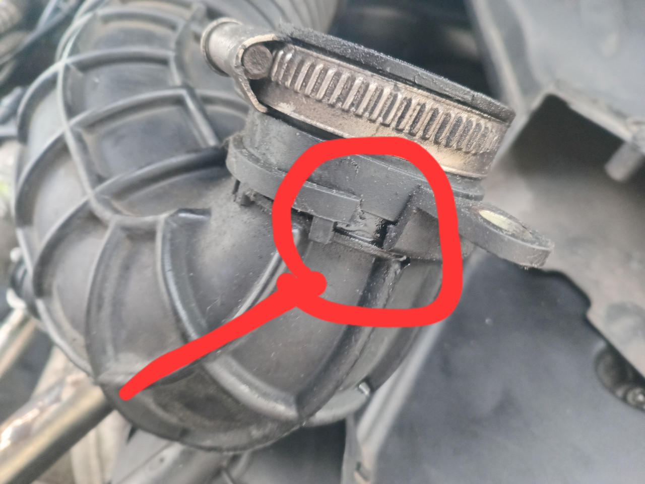

Take a look what i have found today!
  • Wow

Kaput! :)
Yes Uwe that's the word!
Today i tried to fix it as i can with a plastic necklace and no smokes when accelerate!
But when i took the road the necklace didn't resist to my accelerations and smokes comes back!
I ordered a new, this day and i will receive at the end of next week.
Thank you all again!

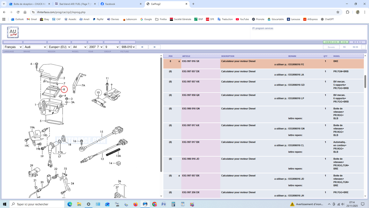

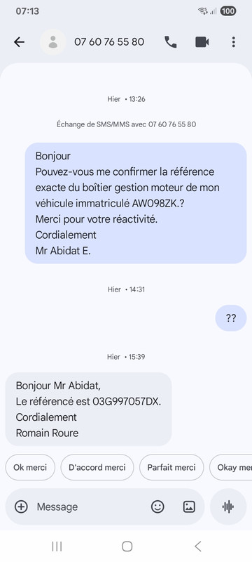

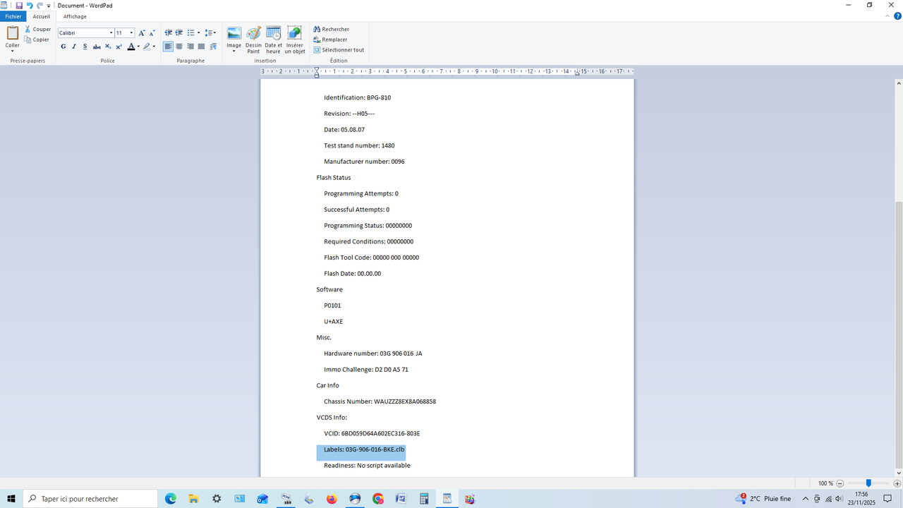

In my grey card it says BRB!
Yes, 03G-906-016-JA is a BRB ECU. But the same label file is often used for an entire family of engines that have essentially the same characteristics. So the fact that VCDS is using the 03G-906-016-BKE label file is not a problem.
