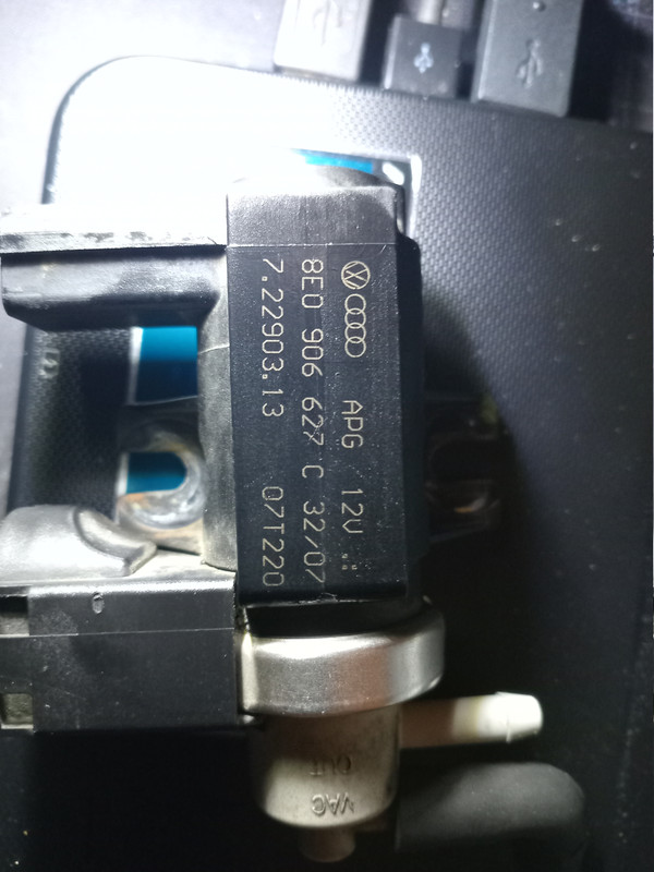

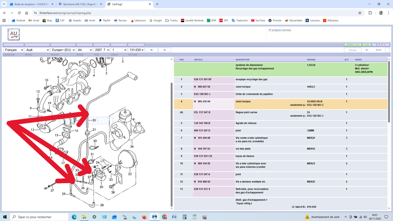

But do you think that my problem can be that circuit in the pic i joined?
8E0906627C TRANSDUCER OF PRESSURE

i mean the hoses of this

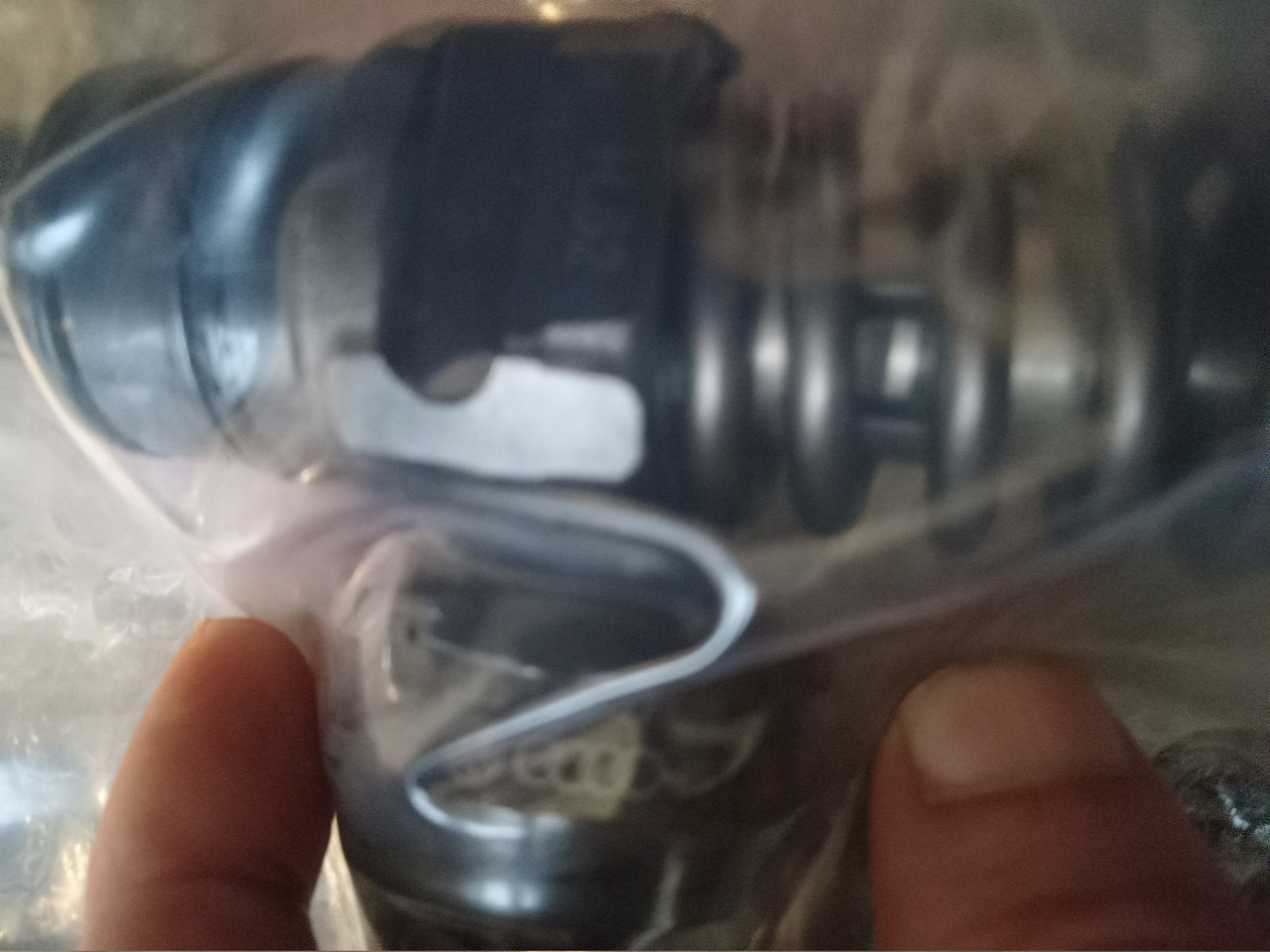

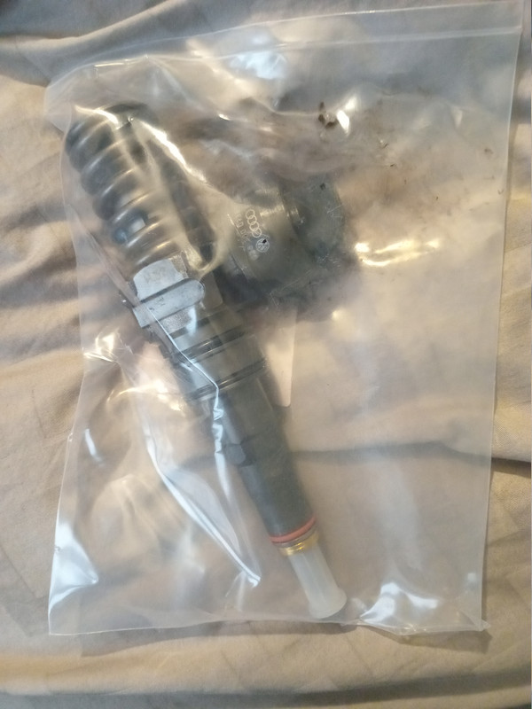

Hello all,
Here are the model of injectors i received yesterday!

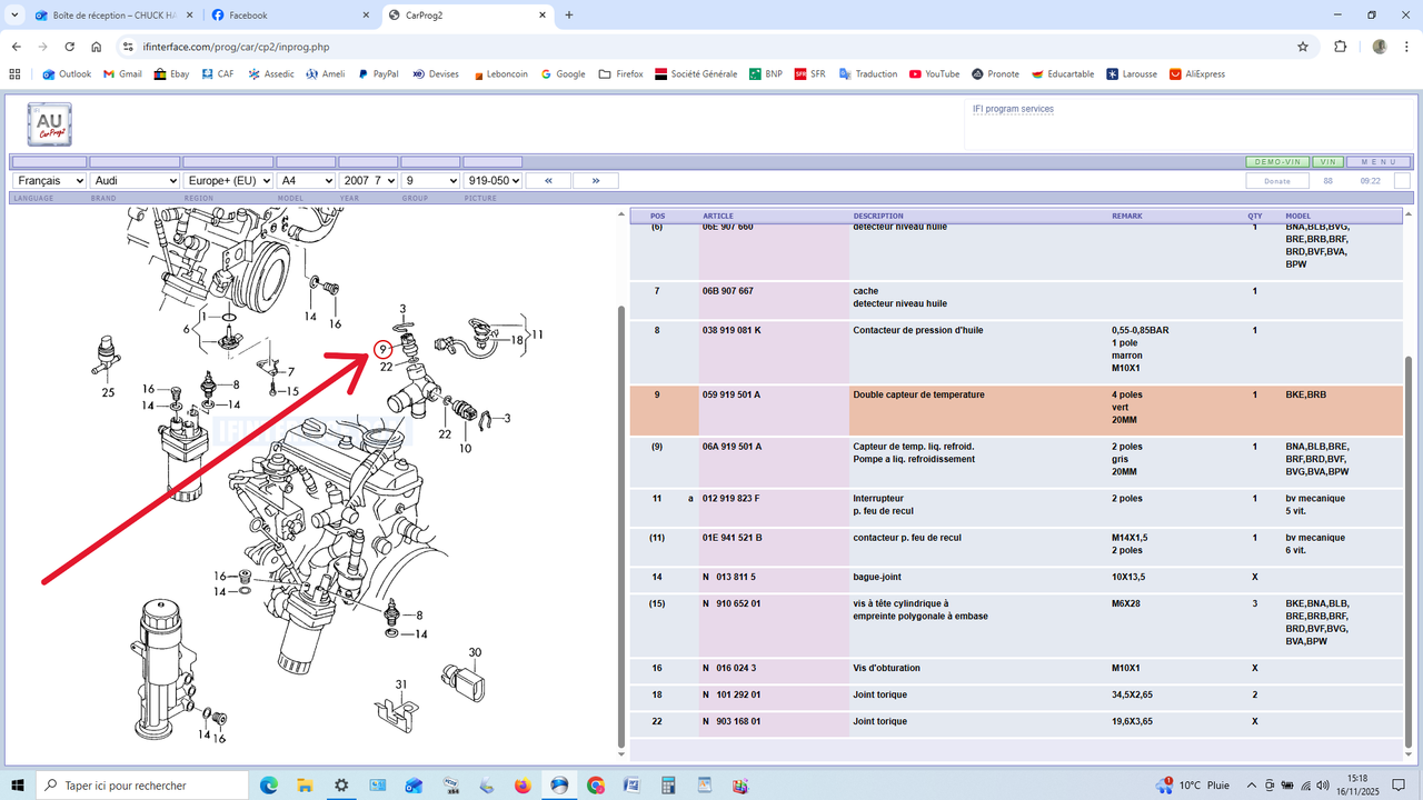

Hello Dr Sheldon,
Tomorrow is the D day!
I have a rdv to change my injectors at the mechanical.
I decided to change also the in parallel of the injectors the double temperature sensor (Double capteur de temperature - 059919501A).
Can you confirm with me that it have an impact with smokes if this sensor is faulty?

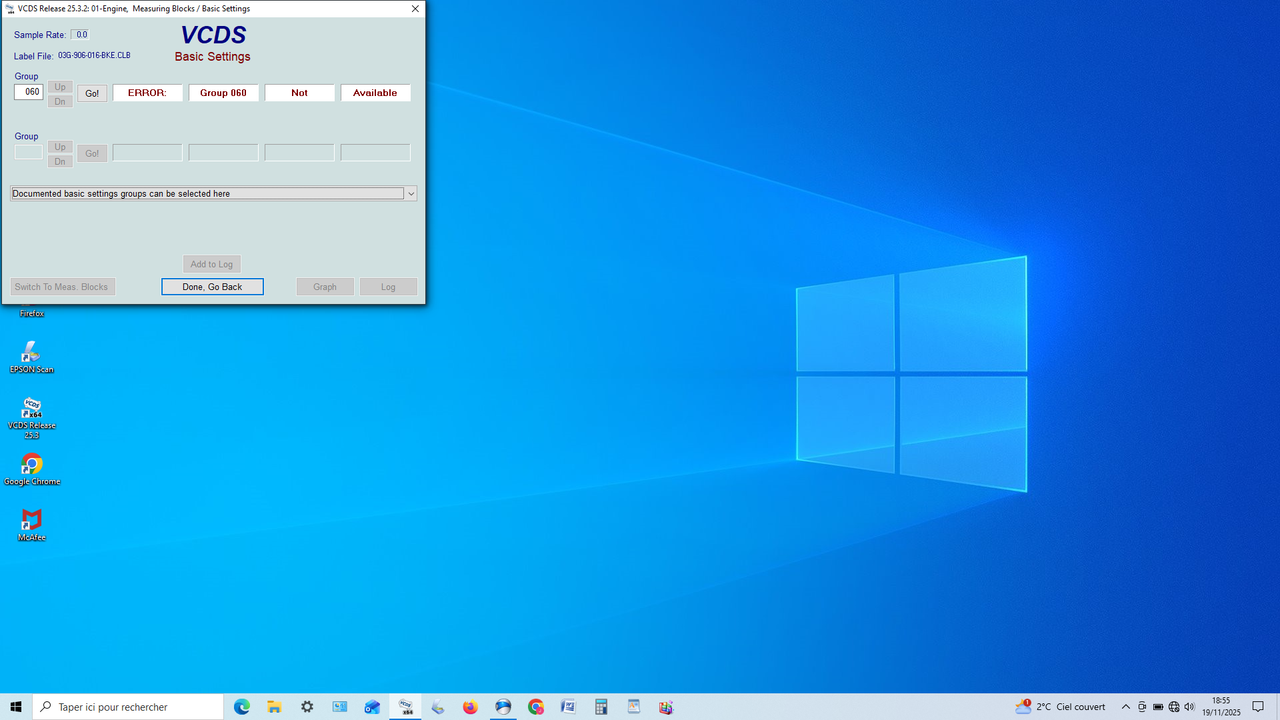

Hello all!
Today i wanted to calibrate the throttle body!
I found that channel 60 or 98 on VCDS was marked error!
Can you tell me if it is normal or not?
