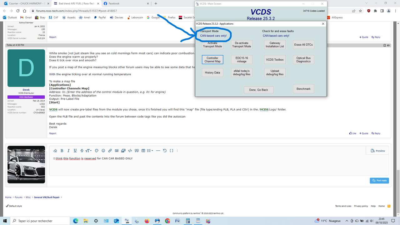

I think this function is reserved for CAN CAR BASED ONLY

I think the map function should work on your engine, but I couldn't see your error image as imgur does not work in the UK anymore
Please use https://postimages.org (no account needed)

Yes it's cool running no particular signs that makes us thinking about any problem!
Here is the pic i sent you before

The CAN only message does not apply to the channel maps, you can still use the map function
