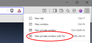

Suggestion.... download and fire up https://www.torproject.org/download/
You can typically get around low level blocks using that.
The Brave browser has TOR built in. Brave is like Chrome, but without the Google spyware, and with a built-in ad-blocker, as well as TOR.
